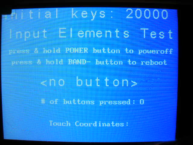

Hi Co,
on top of the button test there is an initial code. I think it is 20000 and that means "touchscreen press detected"...
« Reply #301 on: 22. November 2017, 16:25:14 »
Hi Co,
probably your touchscreen is bad, and reports "I am pressed". This leads to the keypress test screen.
See Wiki: https://github.com/df8oe/UHSDR/wiki/Firmware-FAQ#q-why-do-i-get-the-blue-screen-at-power-on
Co

Coordinates and interrupt are independent...
Again: what is the initial code when you are in button test by accident?

Andreas,
The code is 20000.
reagards
Co
Posts: 6290
« Reply #305 on: 23. November 2017, 05:04:25 »
That means that during startup a touchscreen event was detected.
I naver have had that - but there are some others who did have it, too...... Thomas, DL8EBD, can you please give some infor about that issue?

Hi Andreas,
(btw: You are an early riser . I agree it is unsolicited interrupt. With a damaged TS you get the value 10000. I have the impression it is a timing error. I followed the discussion with Thomas on this issue but do not know of any final conclusion.
Of course I can force the active low TS-Int to a  high level to skip going into testmode but that renders the TS inactive.
regards

« Reply #310 on: 23. November 2017, 10:31:23 »
Hello Andreas,
If I install the LCD with the damaged TS (damaged flatcable) it is impossible to execute the button test !! Holding the power button starts normally with the splash screen immediately followed by the button test screen specifying "POWER" and immediately followed by "POWERING OFF .." ,  then indeed powering off.
I gather entering the button test test would mean letting the power button go in the right split millisecond.
regards

« Reply #313 on: 23. November 2017, 15:18:08 »
Hallo 20000er,
bitte sagt mal, wenn beim Start der Code 20000 kommt, was steht dann auf dem Display:
"Touch (no coord.)"
"Touch (no cntrlr)"
"Touch"
Stehen unten "x/y" und dann Zahlen?
oder macht einfach mal ein Foto.
Danach richtet sich die Fehlerbehebung / -vermeidung, die wir einbauen werden. Gänzlich ausschalten ist eine ungute Idee.
Wenn mein Verdacht bestätigt wird, dann werde ich ganz schnell eine Lösung haben.
Danke

« Reply #314 on: 23. November 2017, 16:23:20 »
Hi Danilo,
two pictures
no 1. Immediately after the splash screen
no 2. after a random touch on TS
regards
