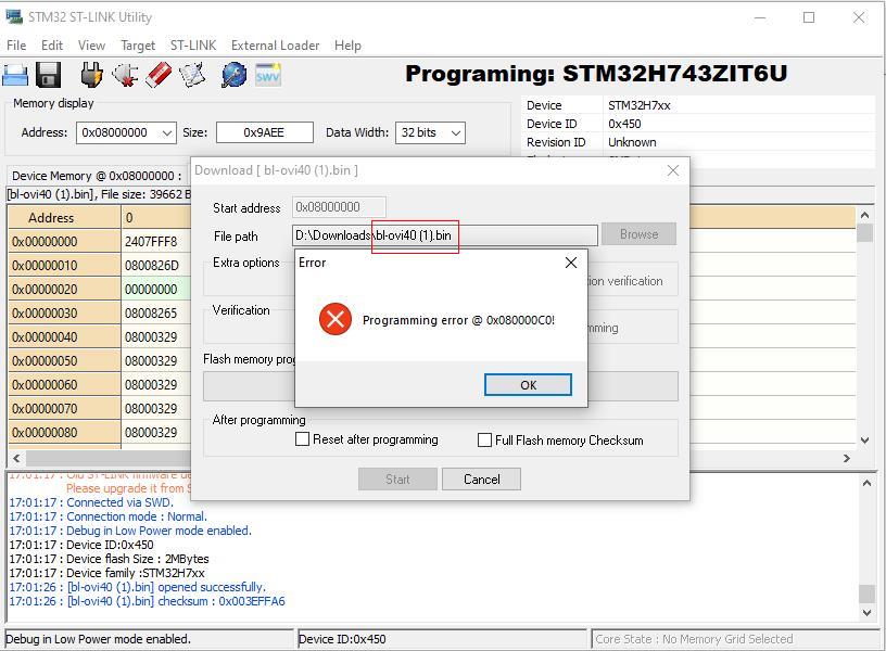

Hi
Thomas, I can't upload the bootloader (https://www.amateurfunk-sulingen.de/uhsdr/bootloader-latest/OVI40/H7/) to the STM32H743ZIT6U.
I have an error like this:
What am I doing wrong?
Artur
SP3OSJ
Re:Baubericht: UI mit 480MHz STM32H743ZIT6U
« Reply #17 on: 02. September 2020, 16:29:58 »
Old program?
Thomas, what version of ST32-Link are you using?
Posts: 6290
« Reply #18 on: 02. September 2020, 16:41:39 »
It can be related to an outdated firmware revision of your ST-Link, too.
SP3OSJ
« Reply #19 on: 02. September 2020, 17:18:55 »
The fault was the old program on the new one is OK thank you
SP3OSJ
« Reply #20 on: 03. September 2020, 08:18:42 »
Is it possible to block the STM32H743ZIT6U?
I changed the settings:
1) Target / Option bites ....
2) Target / MCU Core ...
I'm loading firmware, bootloader and firmware (it's OK) and TRX won't start.
I replaced the processor and now it's OK.
SP3OSJ
« Reply #21 on: 03. September 2020, 08:37:33 »
Because on the old program I could not upload the bootloader
and I thought it was a setup problem (bites and MCU Core).
Posts: 6290
« Reply #22 on: 03. September 2020, 09:35:37 »
The problem of "scrambled option bytes" is present on F7 and H7 MCUs. The reasons are not 100% identified. If the option bytes are scrambled you can only access MCU via ST-Link. First you must perform a "complete erase", then reset option bytes manually to the default ones. critical are the reset vector bytes  BOOT_ADD0 and BOOT_ADD1. If these are acrambled MCU does nothing more than power consumption and listening to ST-Link
