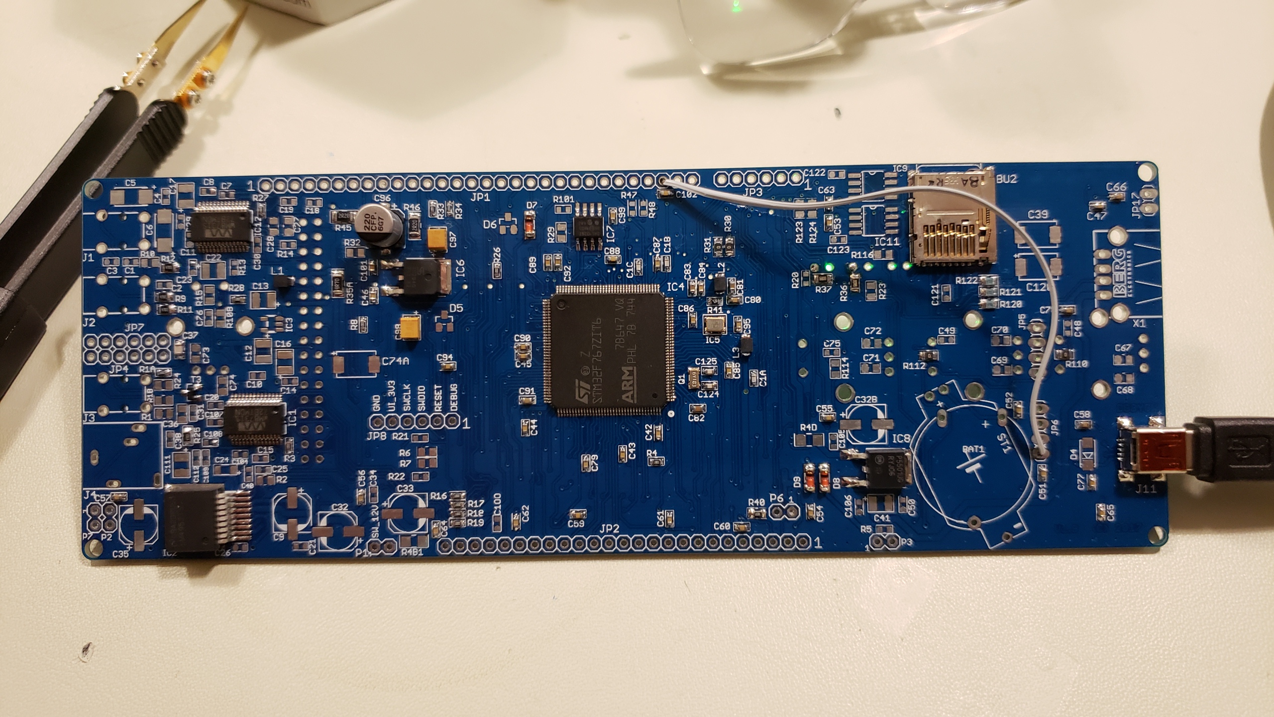

4. Provide 5V from mini-USB by wire connecting JP6 and pin 28 on JP1 (see photo)

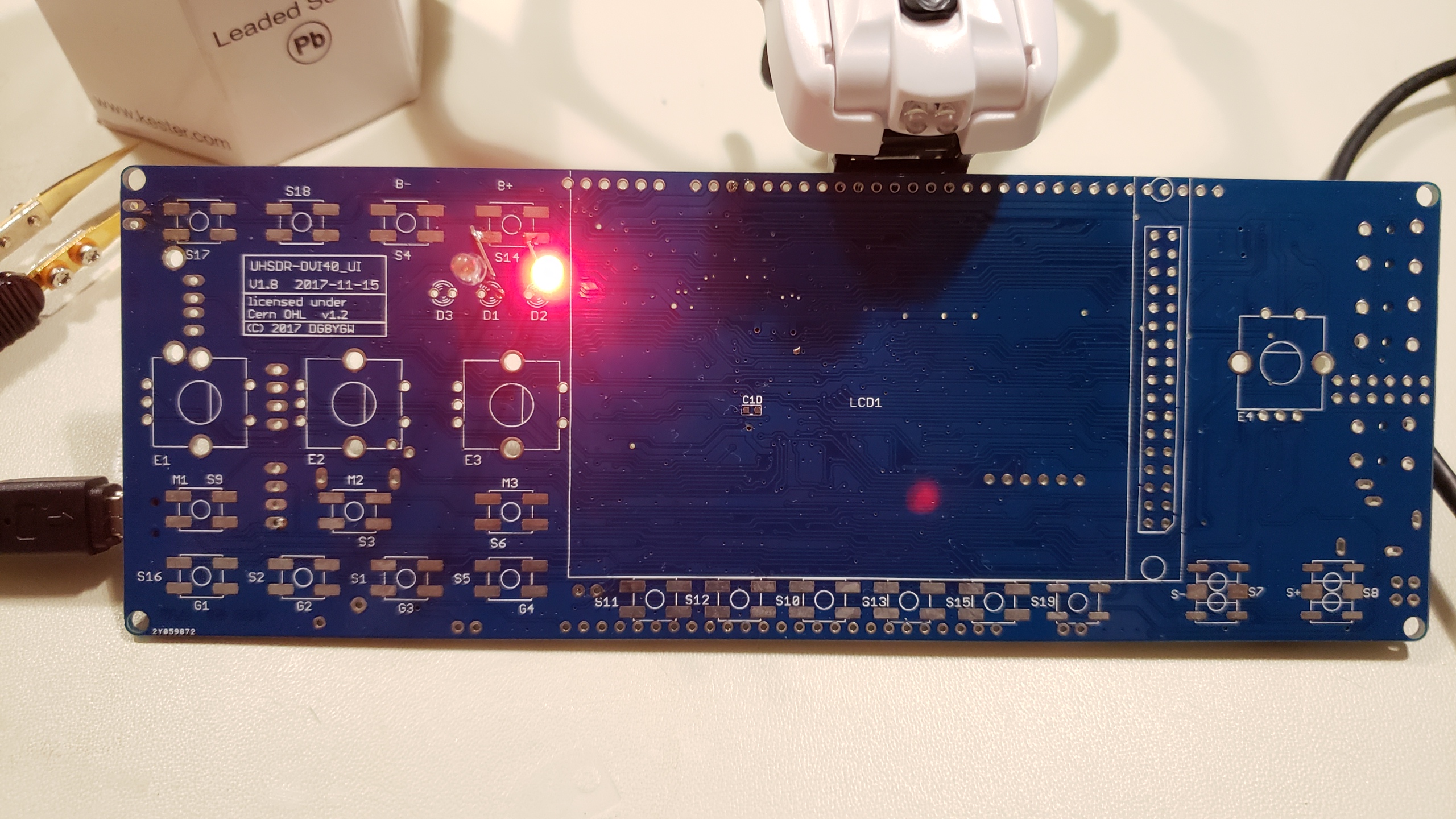

1. solder resistors R36, R37 (the ones connected to D1, D2 Led diodes).
2. solder LED1 and LED 2 (I have installed them just provisionally, because I have removed them after the test - it is easier to solder other SMD parts).
3. Again connect the mini-USB to your PC USB and enjoy the LED show!
4. First you see RED led turning on.
5. Then both RED and GREEN leds are lit.
6. It takes some 10s for RED led to go off.
7. In the end just GREEN Led is lit.

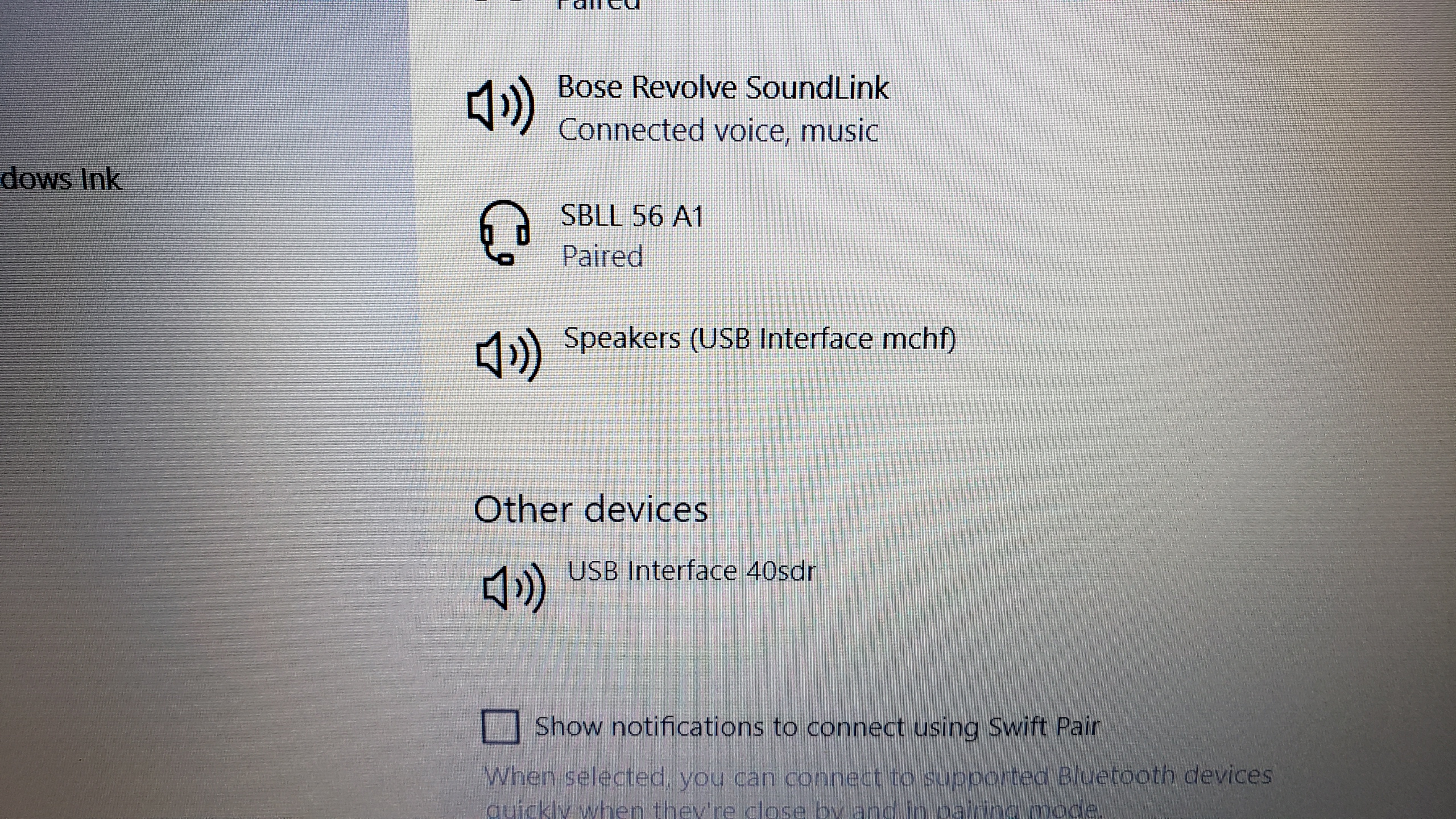

8. Check your PC and connected devices, look for "USB Interface 40SDR", and "Speakers (USB Interface mchf)". The last one might write differently on your PC since I am using the same PC to run mcHF Rev 0.7 as well and my PC sees the OVI40SDR as the same sound device.
9. Now you have visual confirmation that your MCU is functional and you can continue soldering the rest of the parts.

For the reasons unknown to me, photos were not included. I will do it one by one. So here, as promised:

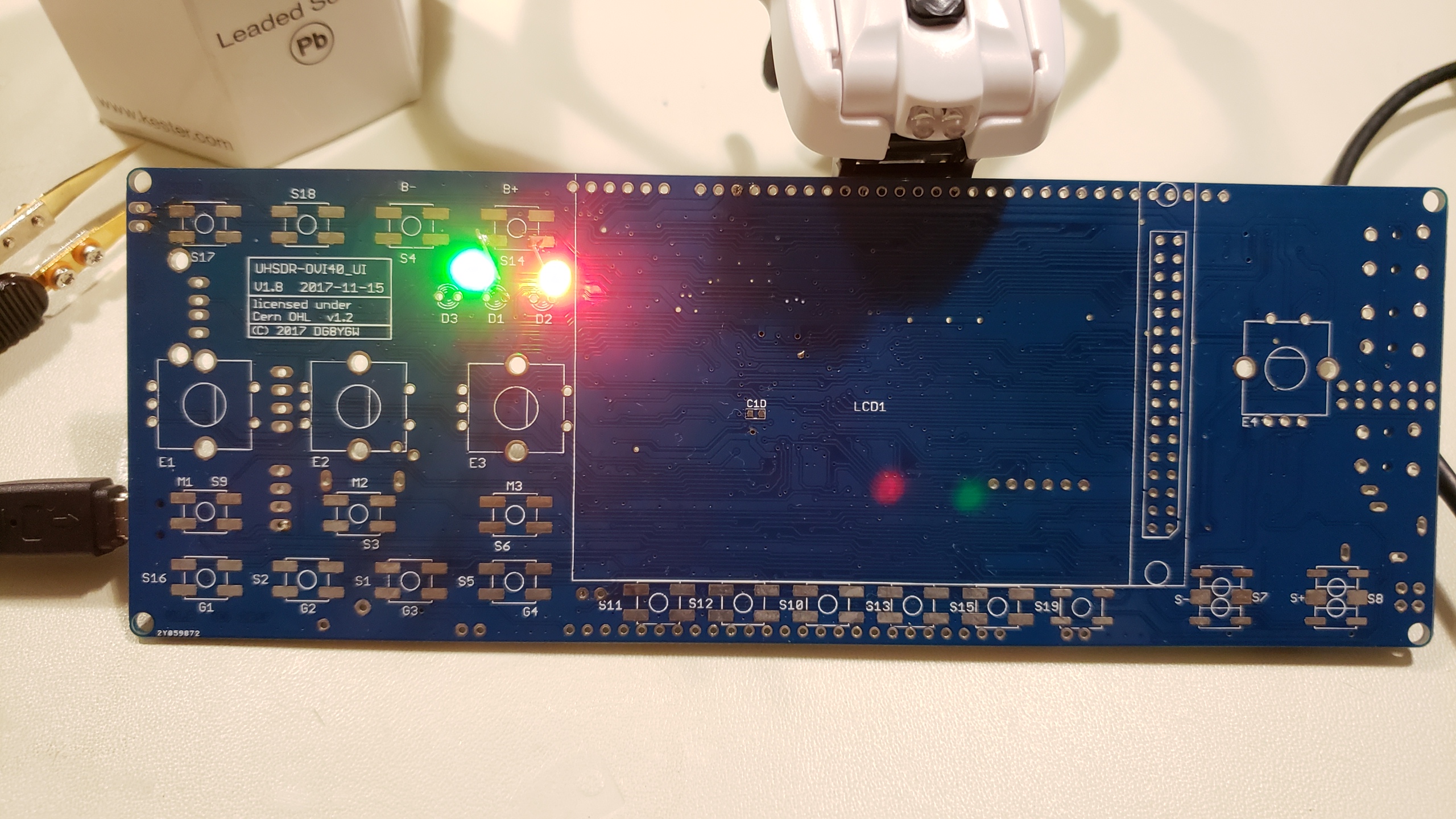

Photo nr. 2 (OVI 40SDR starting)

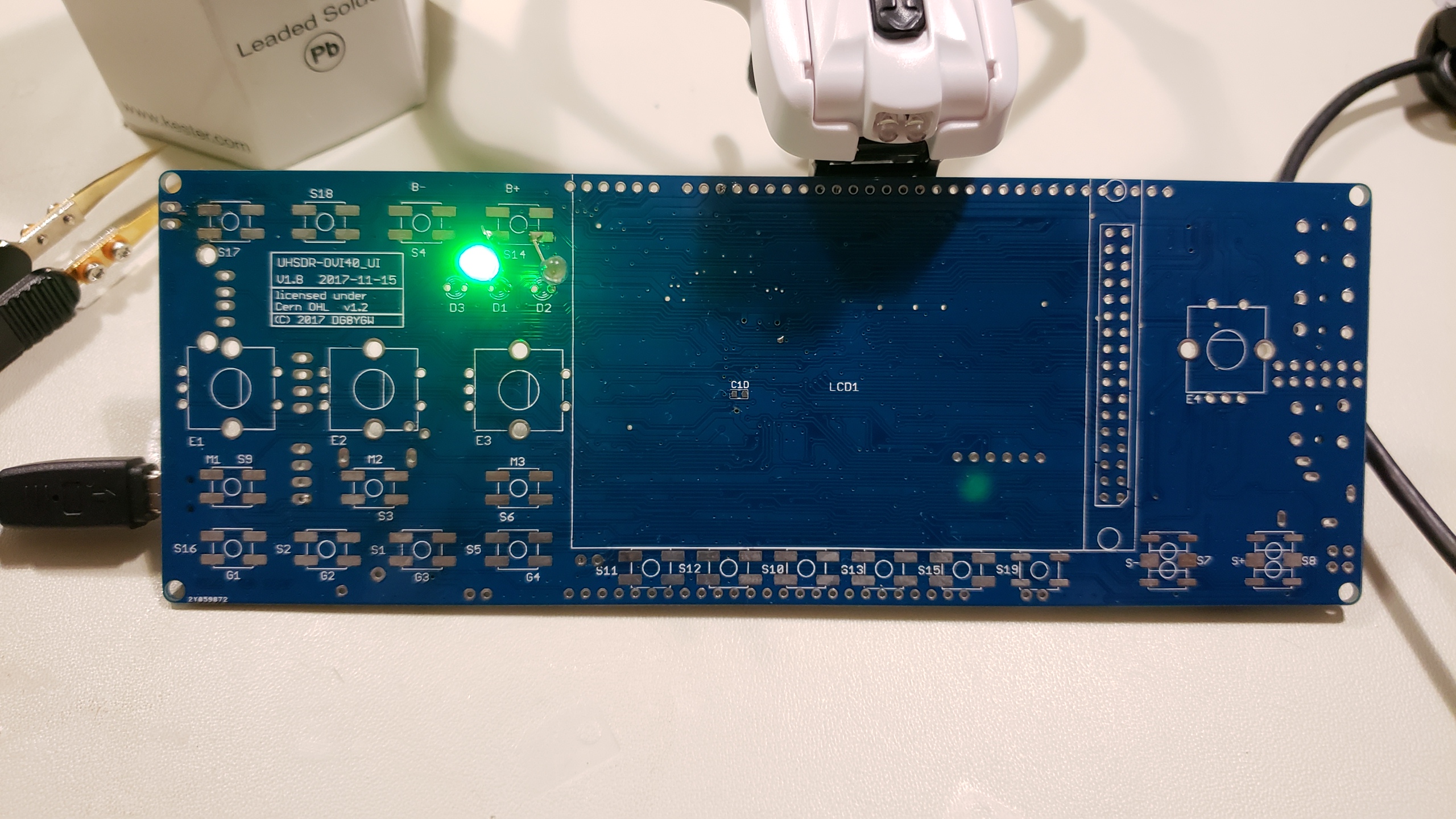

Photo nr. 3 (middle step):

On the view on your PC hardware settings:
