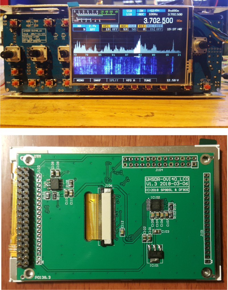

Hi guys,
some time ago Michael asked about a lcd board for 4inch lcd for OVI40 UI. Although my answer is related to OV I40 UI but not directly to Helmut's opening message of this thread, I can say: well, there is no need for separate board nor modify existing one if one may agree to some disadvantages. Look bellow please at our ordinary 3.5" lcd board with 4 inch lcd, there is no workarounds needed. One of the lcds available on Aliexpress exactly fits. Just remove the 3.5" lcd and insert new one. As you may see the lcd is quite big and almost collides with the knobs, but it is possible to put it there if one wants it.
The object on Aliexpress:
https://www.aliexpress.com/item/4000817659016.html?spm=a2g0s.9042311.0.0.2ff75c0fyXW9bl
Please be careful when ordering, select the "SILI9486 touch" !
The picture of SParkle DDC with 4 inch lcd working since over a month:
