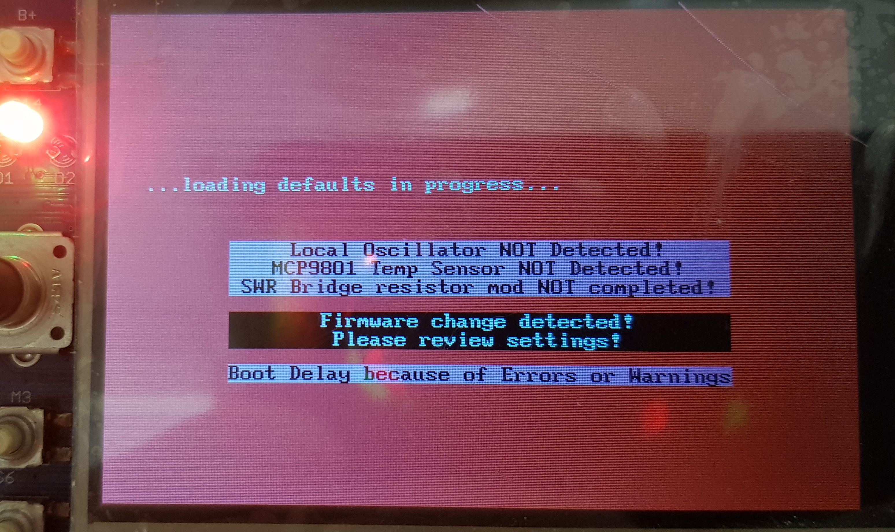

Thanks for the F1+F3+F5 tips. This is what I get (see picture) and then I get the UI again.
Posts: 6290
Re:Firmware loading trouble
« Reply #16 on: 26. March 2018, 03:31:35 »
Perfect!
Because of you do not have fitted rf PCB of course no local oscillator, temps sensor, SWR mod can be detected and this leads to the warnings. All is 100% ok.

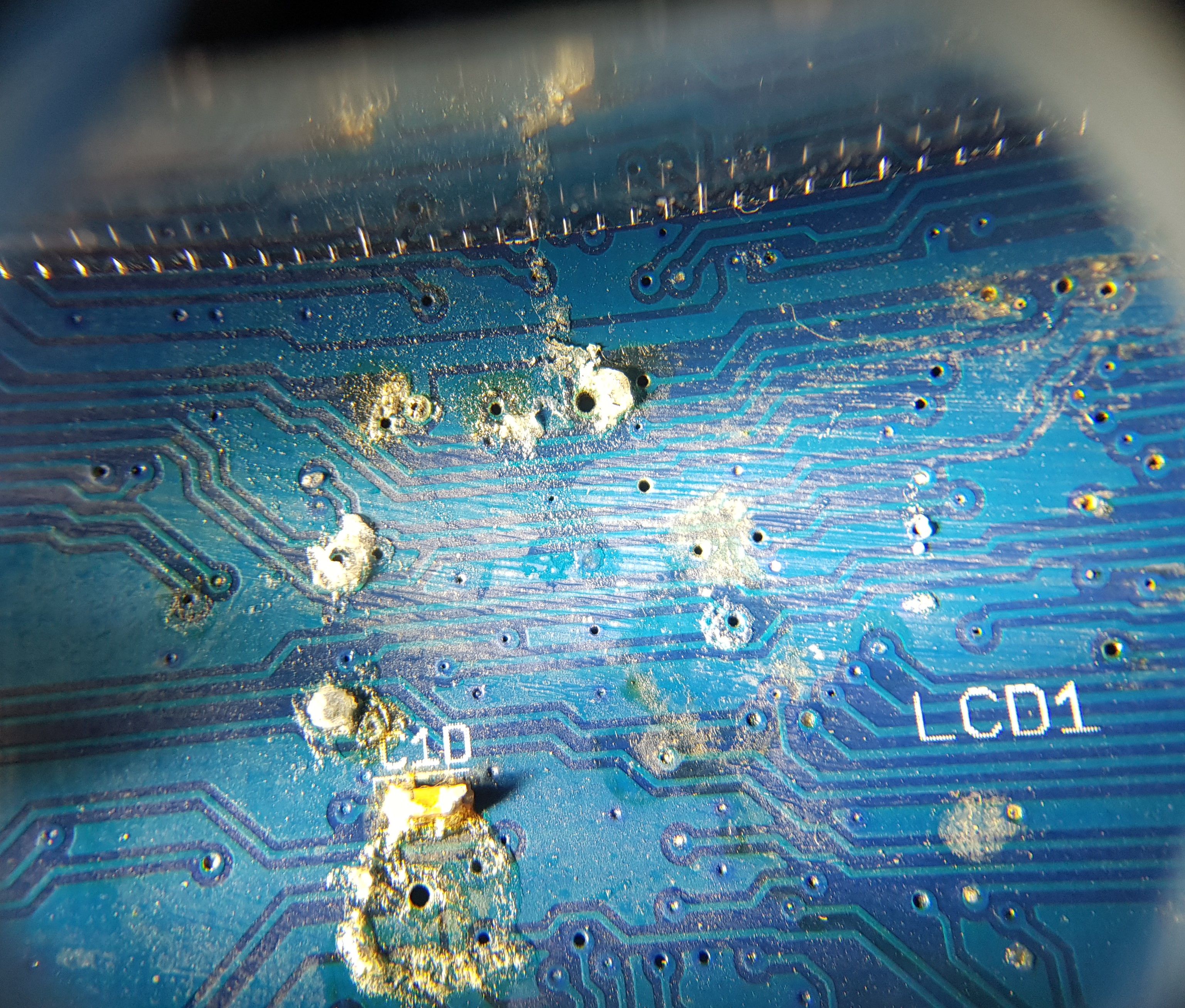

Now I know salt is the culprit! My mistake was to use IPA extensively for cleaning. I didn't know that this solvent is nowadays never used professionally. I have learned now to use just distilled water and an ultrasonic washer, if available.
My card is now probably so full av salt that it may be impossible to clean it again. But I'm in no way discouraged by my mistake. Instead I see this as a learning experience. And I will go on and try to get this board working. And I will build the RF board later. Now I have so much more experience :-).
When  I de-soldered the MCU I discovered the magnitude of the problem. In the picture you can see all the salt that was trapped under the MCU. It was squeezed through the wholes while desoldering with hot air.
My next step will be to wash with distilled water and an ultrasonic bath. My friend has one. I will put in a new MCU. However, I suspect there will be salt under just every component so I don't have high hopes. But I will at least try - as a part of my learning :-)
Most likely I will end up buying a completed board when available, because it's a bit tedious to build exactly the same board again . But I will build the RF board kit as I now knowhow to do it the right way :-)
Thanks for all the support! I love the project and I'm looking forward to next phase!
Ulf
« Reply #22 on: 28. March 2018, 08:52:16 »
Hi Ulf,
This is hmmm.. really ugly! What kind of flux are you using? I use the IPA for years and NEVER had any issue similar to yours...
The one I use is 99.5% C3H7OH. AFAIK there is no salt in IPA itself (look at the formula) it must be originated from something else like flux...
Posts: 6290
« Reply #23 on: 28. March 2018, 09:03:47 »
I recommend RMA-223-UV. It is no-clean and I never have had any problems.
But too late for you - the only solution will be "cleaning"...

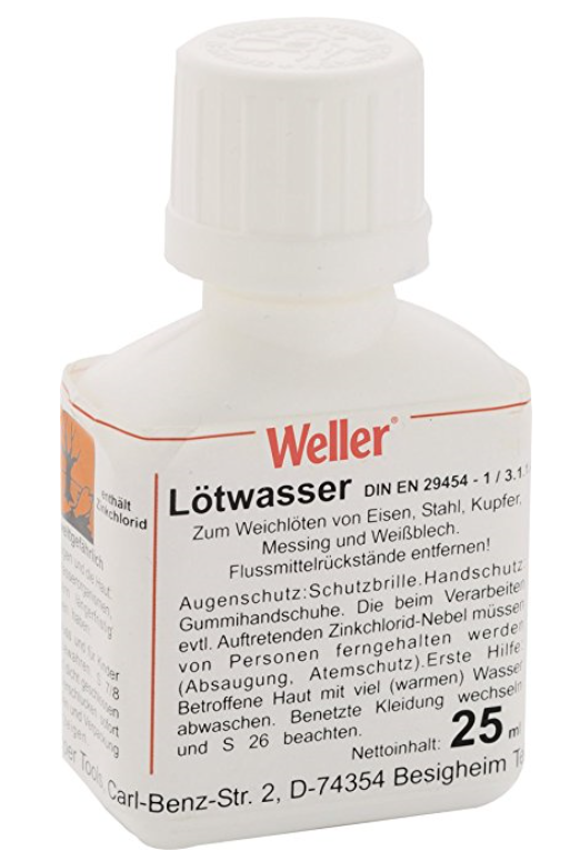

This is the stuff I used, sold here in a chain of hobby-stores - not proffesional electronics.
It contains ammonium and zinc chloride solved in water - salts! "Real" flux should contain rosin solved in IPA. So, you are right, Slawek, IPA is not a problem. Nor where there any chemical reaction involved. The flux I used left its salt when the water vaporized. And these salts are most likely not solvable in alcohols - but in water! I still have som hopes for a water bath which I will try with today.
Mystery solved!

Posts: 6290
« Reply #29 on: 29. March 2018, 07:20:19 »
This one is absolutely unsuitable for electronics and SMD. I hope your PCB can be rescued...
