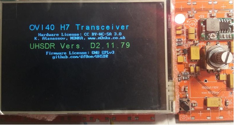

Macsim Gheorghe
Re:Problems UI with F7/H7
« Reply #16 on: 09. March 2020, 20:43:54 »
Hello!
I have done everything you advised me to, but the same thing keeps happening - the welcome message lights up, it stays like that, the LED is on, red. I have checked that everything works fine, but it doesn't go past the welcome message.
« Last Edit: 09. March 2020, 20:49:55 by Macsim Gheorghe » Logged
Macsim Gheorghe
« Reply #17 on: 09. March 2020, 20:54:52 »
Here's what it displays. Remains with this message and the red LED.
« Last Edit: 10. March 2020, 08:50:54 by Macsim Gheorghe »
