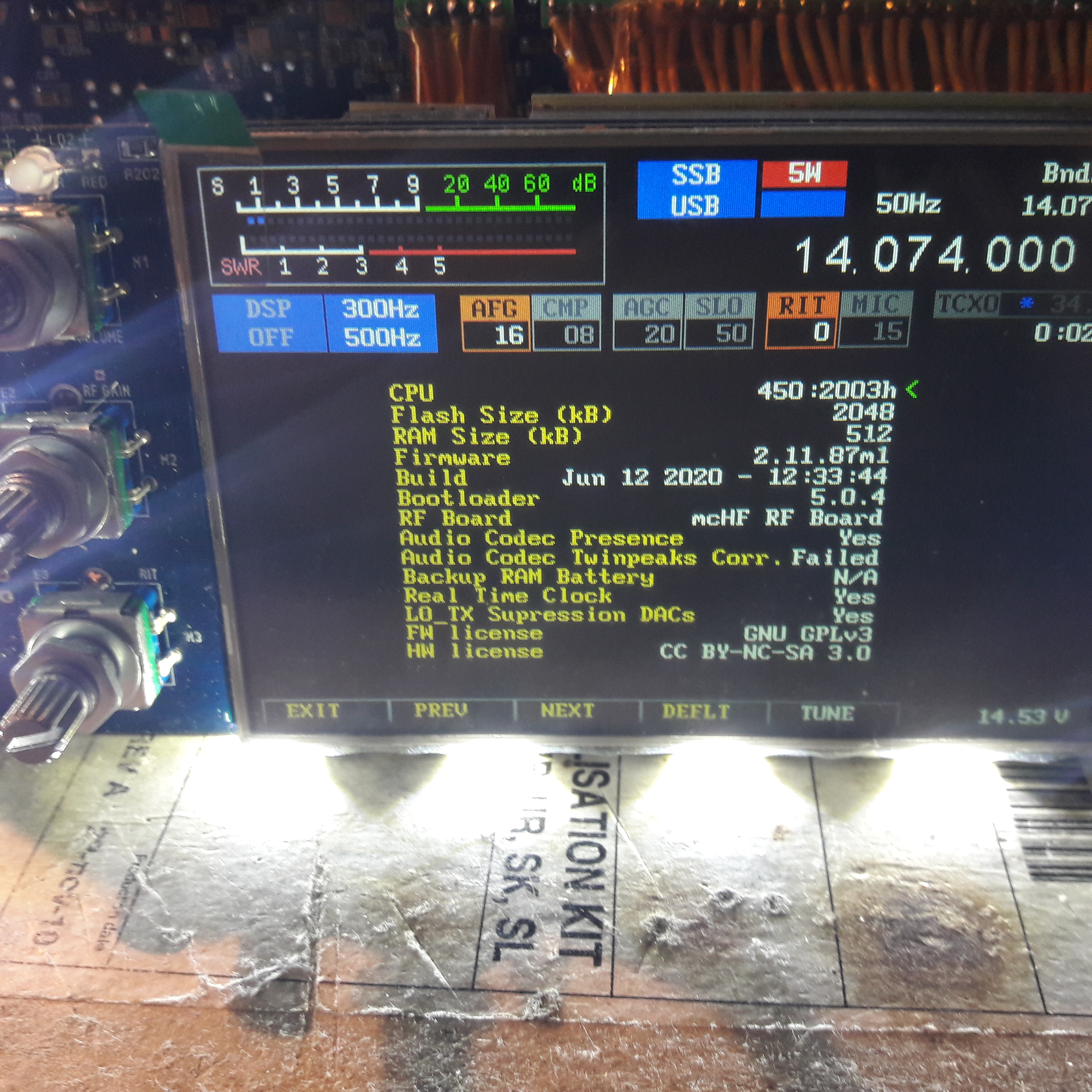

« Reply #3 on: 24. October 2021, 09:58:51 »
I stitched it with an old mod-firmware compiled for Ubuntu. The transceiver works without problems. The root of all evil is in the compiler.
