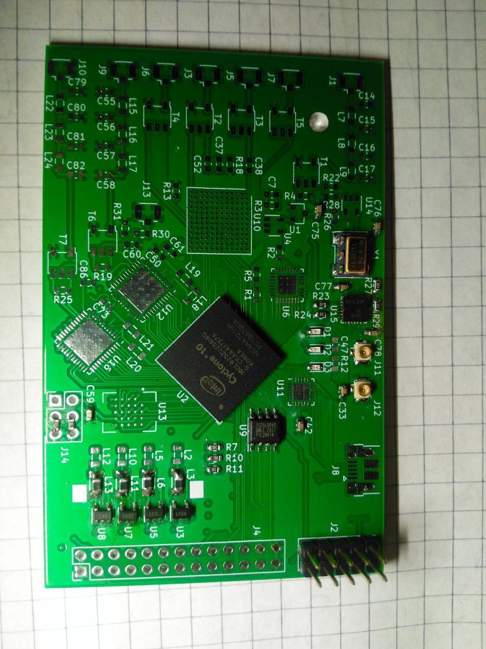

Sep 10, 2021:
This week I got the prototype PCBs (final layout) for OVI40 RF (RX/TX) from manufacturer. It is a six layer PCB and I am very exited if everything is working. Today I started with FPGA (and checked if all balls are connected: they are - and no short circuits). This weekend I will populate more and more parts, every step checking if everything works as expected.

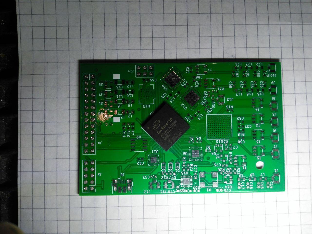

testing FPGA (1)
« Reply #2 on: 11. September 2021, 11:29:09 »
Sep 11, 2021:
Everything mounted to program FPGA (top side)
« Last Edit: 11. September 2021, 11:39:07 by DF8OE »

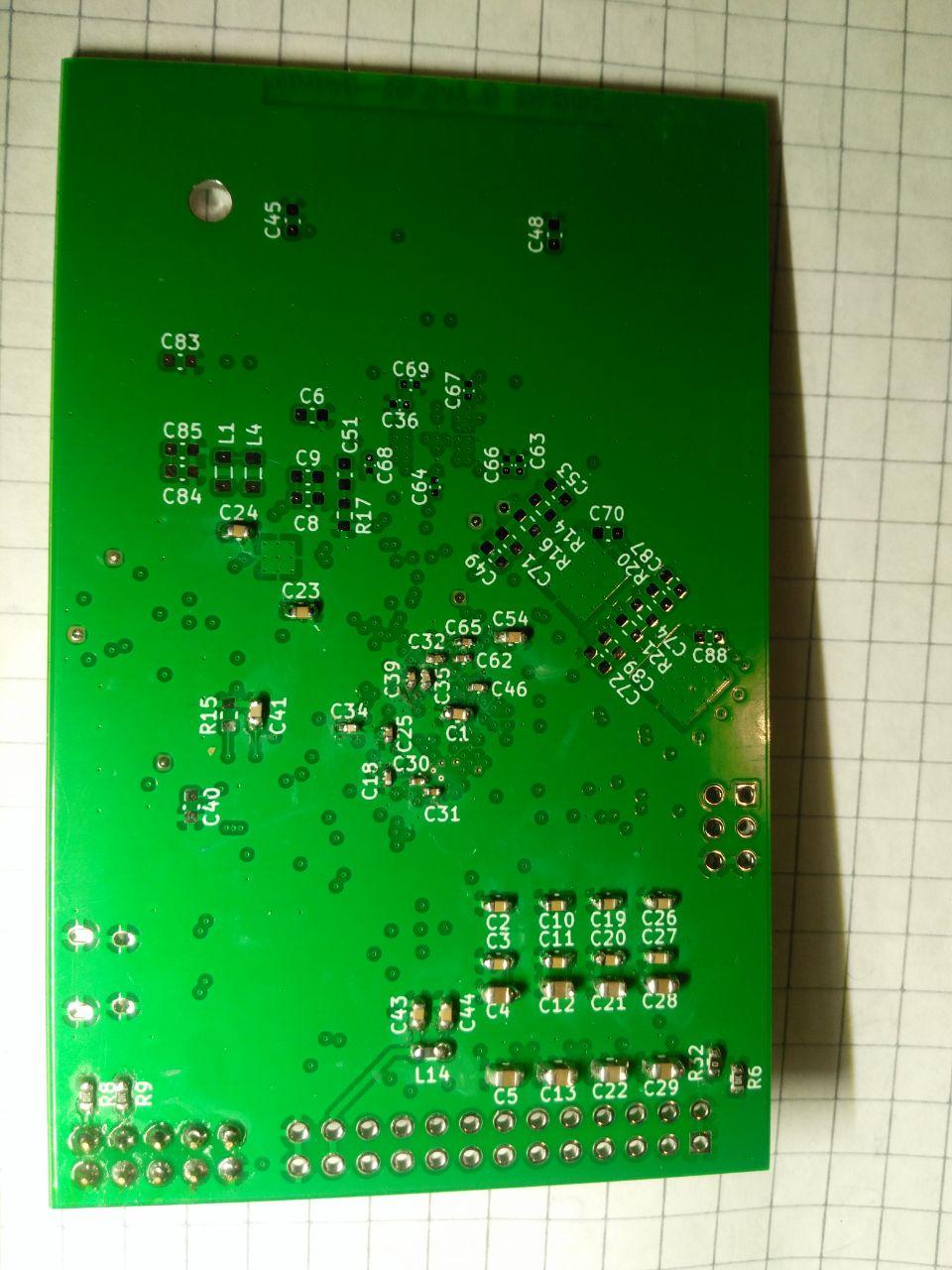

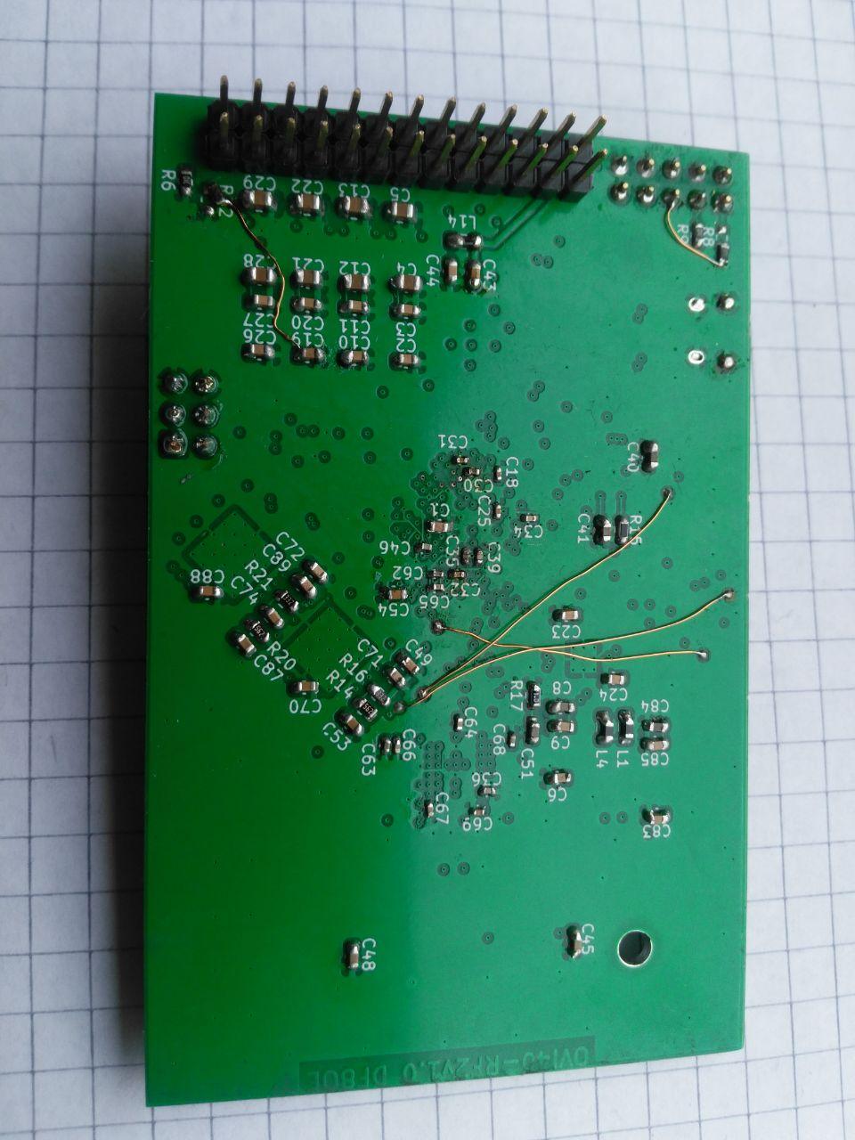

testing FPGA (2)
« Reply #3 on: 11. September 2021, 11:29:48 »
Sep 11, 2021:
Everything mounted to program FPGA (bottom side)
« Last Edit: 11. September 2021, 11:39:22 by DF8OE »

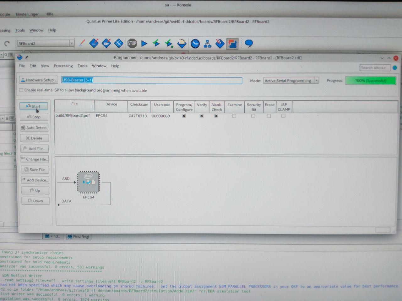

testing FPGA (3)

Sep 11, 2021:
programming successfully finished

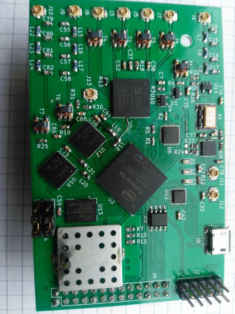

Re:Final RF (RX/TX) PCB Prototype populating finished on Sep 17. 2021
« Reply #6 on: 17. September 2021, 15:08:14 »
Sep 17, 2021:
Hi to all,
today I finished populating of OVI40-RF2. I have checked everything twice and more during populating, measured voltages and currents on several places / tracks.
Of course such a complex schematics (and because of netlist the resulting PCB, too) has some errors which I did not discover before PCBs are manufactured. But until now these are minor errors which can be corrected on the prototype PCBs - not necessary to manufacture new, corrected ones.
I already have transmitted on the shortwave block (10KHz...76.8MHz) and received using both ADCs. So this block can be declared as "not containing issues". Testing of VHF/UHF/SHF block will take some time because of I first must port the Spartan code to Altera. But all voltages and signals on AD9363 are looking fine, data lines are all checked so that I hopeully will confirm working of this stage in the next time.
« Last Edit: 17. September 2021, 15:26:53 by DF8OE »

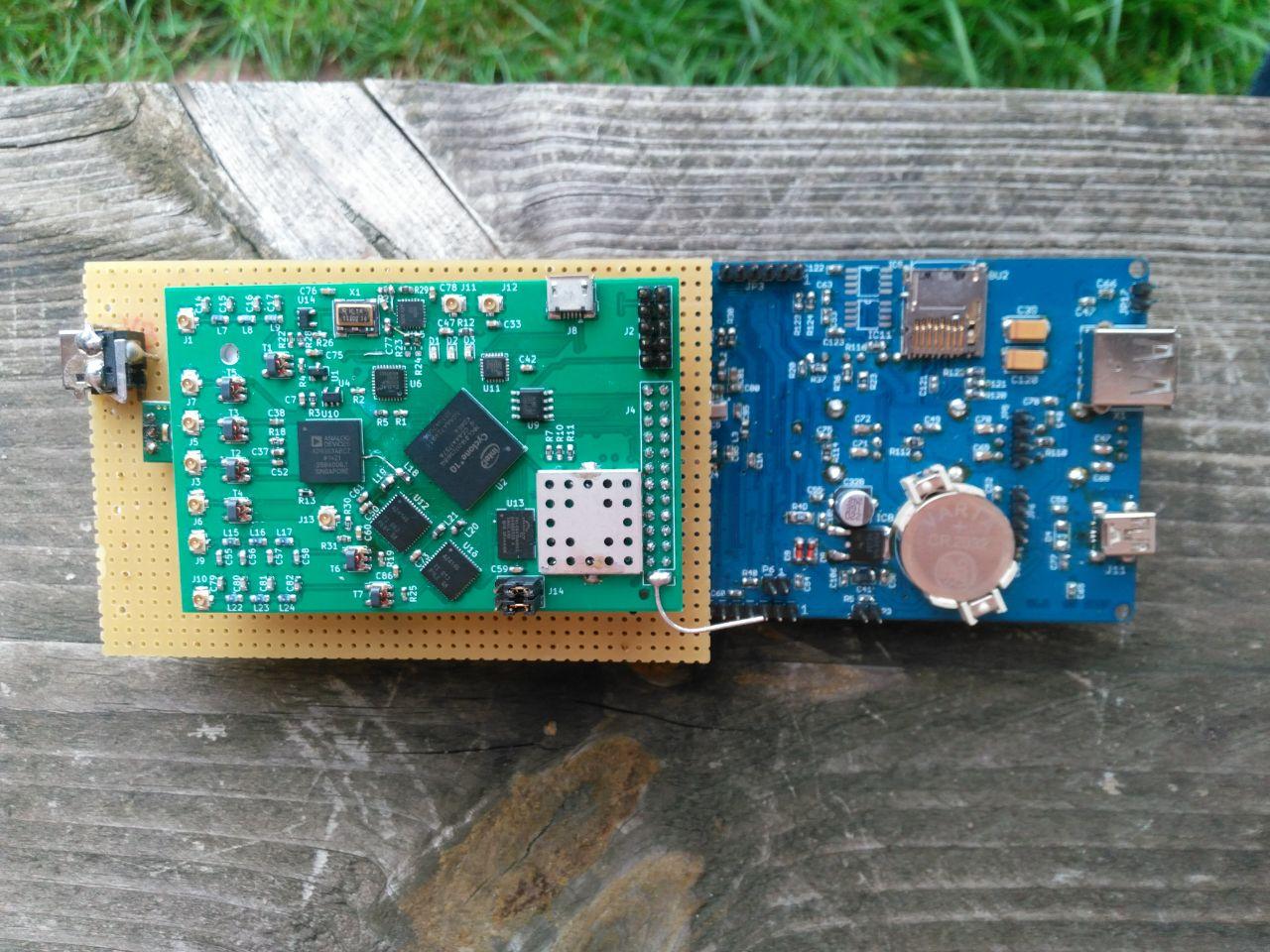

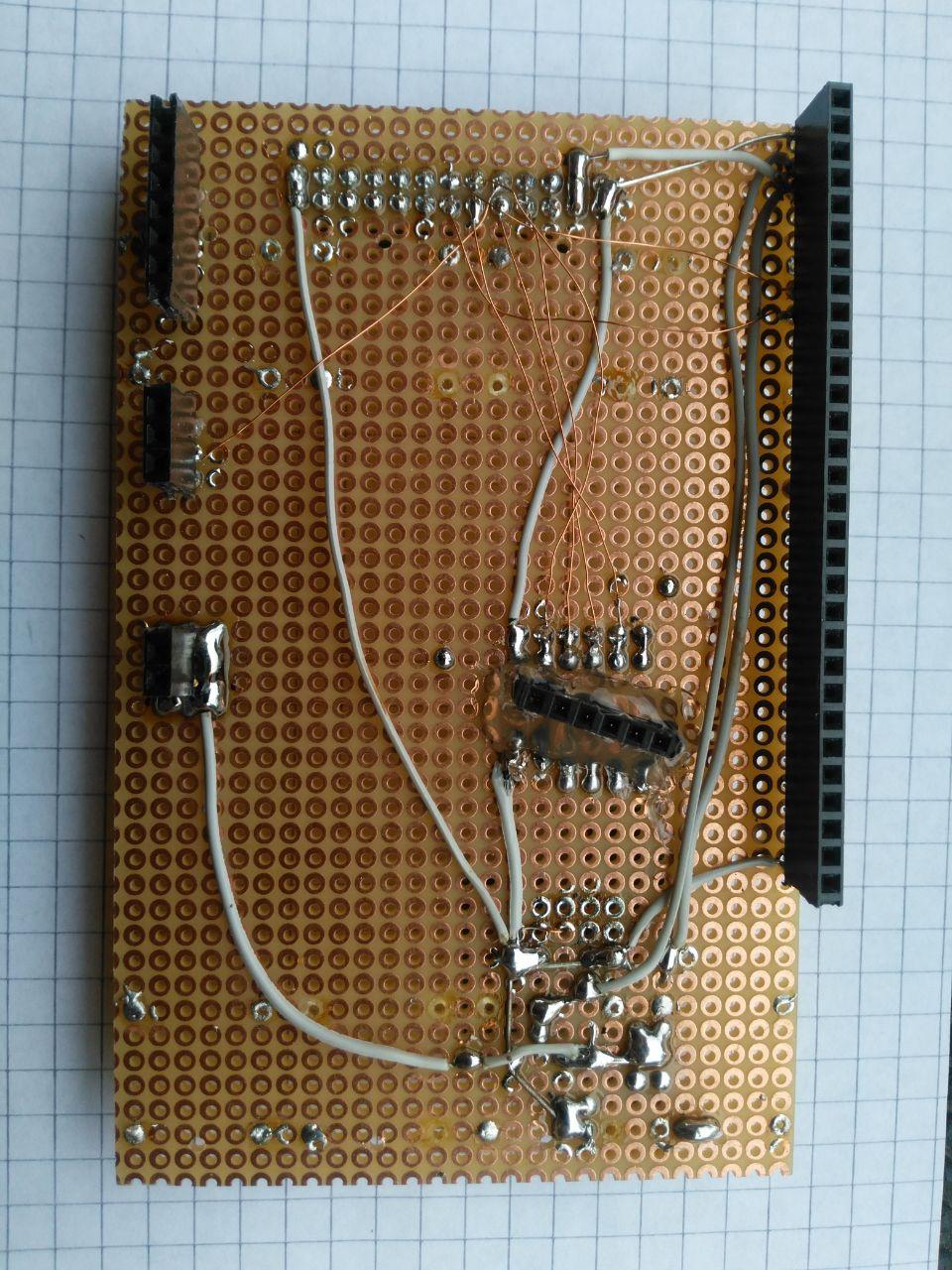

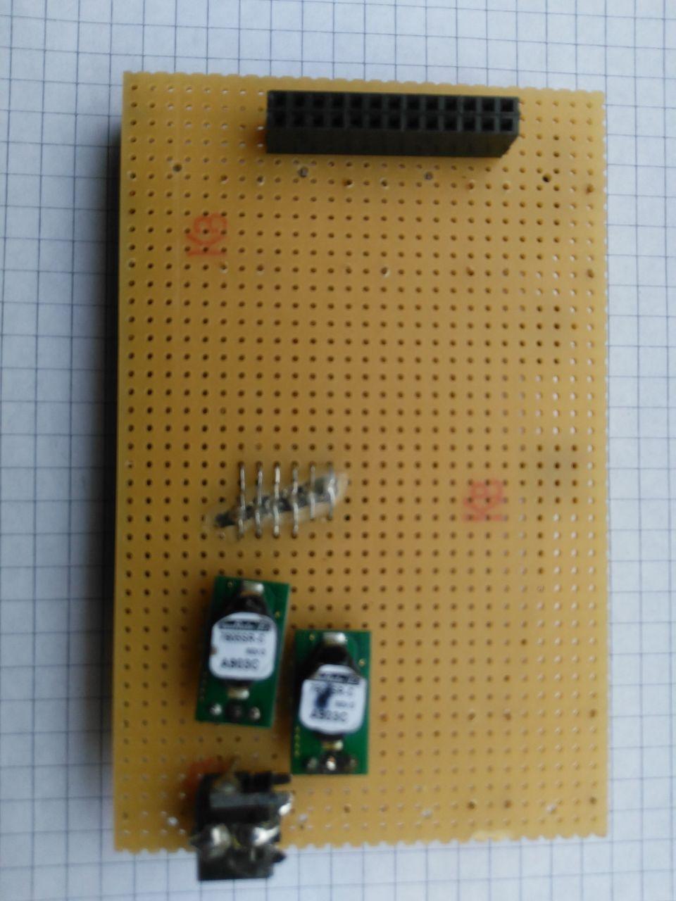

« Reply #8 on: 18. September 2021, 16:15:39 »
Today I build a simple adaptor PCB to marry RF2-Board and OVI40-UI_1.8...
vy 73 Andreas

Now FPGA firmware development can start
