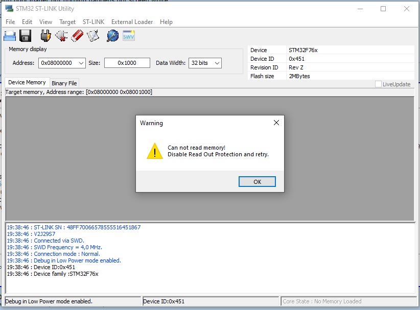

OK, i am lost, hihi
Here is what I see.
I do not know how to set all values to defaults
Can you help ?
Chuck

Re:Dead OVI40
« Reply #4 on: 24. January 2021, 07:46:31 »
Please follow exactly these steps:
For all steps use STLink.
1) mass erase STM
2) enter option bytes setting
3) set all values to the defaults
4) flash bootloader
5) flash firmware
If you do not know default settings please take a look at this thread started by you some time ago
SP3OSJ
Re:Dead OVI40
« Reply #5 on: 24. January 2021, 13:05:18 »
Hi
Target/Automatic Mode/Start
Upload the new software again.
Artur

« Reply #6 on: 24. January 2021, 20:21:42 »
AH, Making progress.
I was looking for that thread, but could not find it.
How do I know which firmware to use H7 or F7??

« Reply #7 on: 24. January 2021, 21:19:32 »
I loaded F7 and all seems well.
Thanks again for all of your help!
