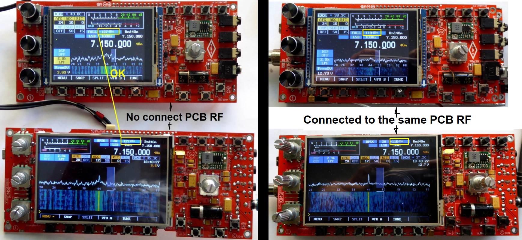

Sound in OVI40 channels is different for channel I for channel Q
Is this good?
Maybe this is the reason why RX has more noise in OVI40 than with the mcHF controller.
A movie with this problem:
https://youtu.be/moNGCHZxbyM

After connecting the PCB RF the radio is working properly.
A good SSB signal (USB and LSB) is decoded
PCB RF connected to the mcHF controller gives less noise
than the same RF PCB connected to the OVI40 controller.
Why?
LCD is more noise and more noise other processor?
Is this a software error?
Check if the controller has the same noise (I/Q) at the converter A/D (RX) input (speaker).
I will be fine if I have a problem

Adreas, this is all true.
OVI has a better receiver signal.
However, the display shows something else.
Look:https://www.amateurfunk-sulingen.de/forum/index.php?board=18;action=display;threadid=1030
If someone has assembled VIO40 controller and speaker (headphones) please let's check to see if the same noise is touching the pin 4 and 5
OK?

Andreas is your mcHF does he have a helicopter? all bands, all freq.
The effect on the movie causes the function:
Menu/Configuration Menu/RX IQ Auto Correction -> ON
DD4WH

I am not sure if you observe the same thing if auto IQ correction is OFF?
The auto IQ phase and amplitude correction algorithm is programmed to be quite slow. It needs nearly one second until it is settled, because of the small alpha in the lowpass filter which smooths the determination of phase and amplitude errors.
The difference in reaction of mcHF and OVI40 UI PCBs could be explained by different intitial phase and amplitude errors introduced by the PCB layout --> just guessing here.
However, that cannot explain why Andreas measures 5dB better performance of OVI40 and Danilo measured 5dB better performance of mcHF . . . but that may be the interaction between UI and RF boards? Andreas uses his own RF board and Danilo uses mcHF RF board. Too many variables here ;-).
