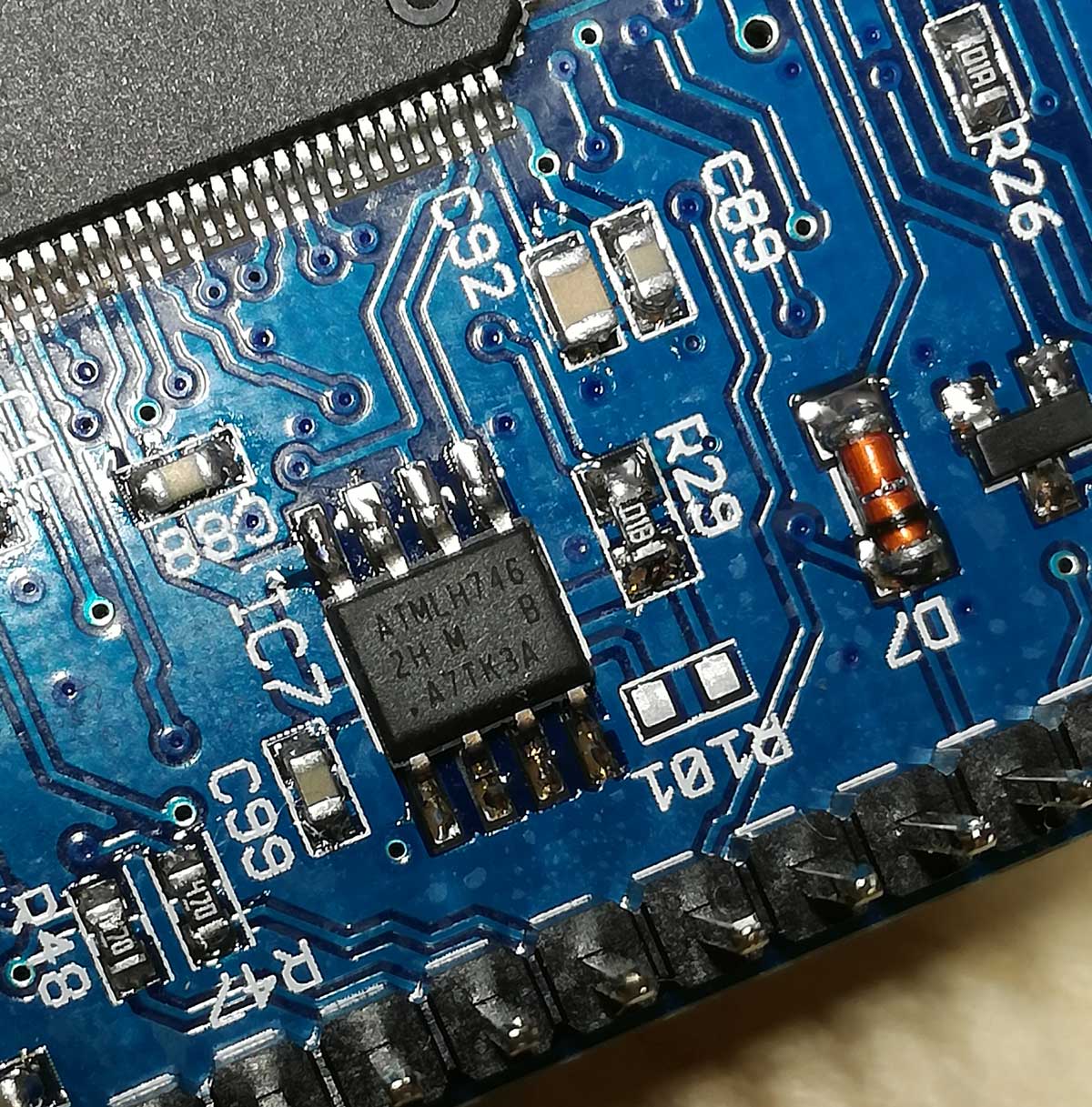

I had a similar problem, MCU-regulator is hot and on MCU-side
2 V. In my way i have the wrong direction of the eeprom.
Look at
https://www.amateurfunk-sulingen.de/forum/attachments/IC7_Einbau.jpg
