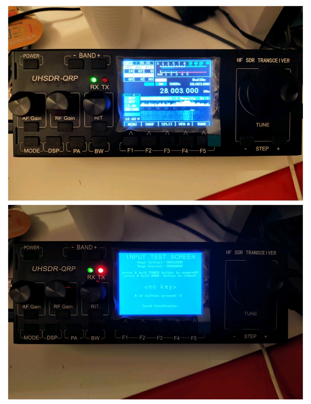

i tried to update firmware unfortunately transceiver not enter in maintenance mode.
I read, for a last version board, is not necessary install bootloader because new firmware will be inside the eeprom.
However I'd like to load, inside transceiver modified 2.12.0 SatoryBoy(for CB frequencies) version but using old procedure is impossible!
1) insert on usb port pendrive with inside last modified firmware.
2) turn on transceiver pushing together "power on" button and "BAND-" button.
Unfortunately transceiver not enter in firmware load mode but enter in display calibration, like the pictures.

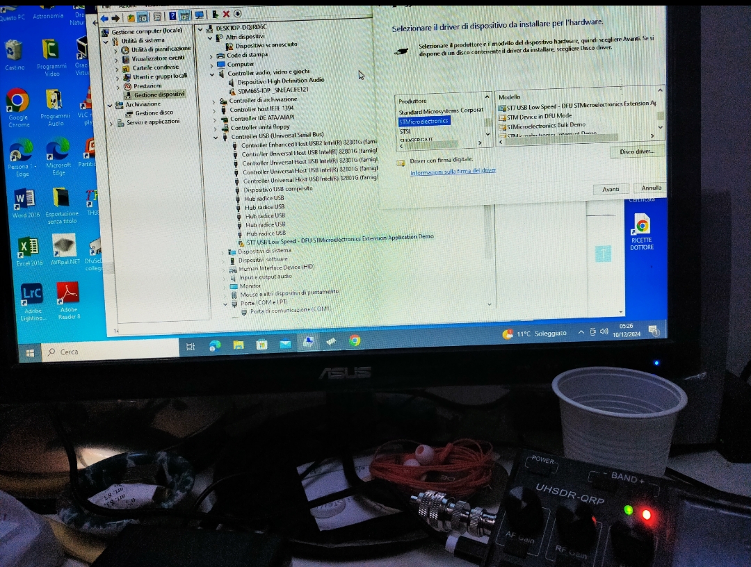

Thank you to your kindly reply, I went in your suggested links, I downloaded last DfuSeDemo + usb DFU ST7micro electronics driver unfortunately the ST7 USB DFU driver is not recognised by windows 10.
I shot a screen situation so you could understand the problem.
Below link to update and driver program downloaded:
klick

I found problem about windows not recognised DFU drivers; Previous days I not found P6 jumper(on the logic board) so procedure bootloader update want P6 Jumper closed. So I found P6 jumper and close it.
When I punched <Power> and <band -  > and plug DFU power to the computer windows recognized DFU driver and I install last Bootloader. After bootloader installation you need to open P6 jumper.
