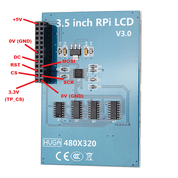

Interestingly, If I use LCD in SPI mode, there is no colour issue, but SPI mode doesnt work everytime. If I try 100 times LCD SPI mode works only 2 times and 98 times I get white screen.  How do I solve this issue?.
I do have raspberry pi 3.5inch ILI9486 SPI LCD, but I need wiring details for it. I read that it works very slow in spi mode, but I am intested only testing it.  Due to covid19 lock down we cannot get things from out side India.
Color issue            =  https://qsl.net/vu2iia/mchf_v0.4_hy28b_parallel_color_issue.jpg
