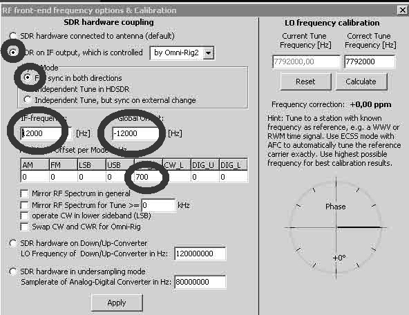

settings in hdsdr see picture
i prefer to see upwards from my working channel (reason is most dx stations work upwards when using split) so set rx tx freq xlate to rx + 12 khz
for sync with hdsdr AND also sync with all other soft using cat set cat diq freq xlat to on
when you have all settings correct then hdsdr and mchf show same area and are synced in both directions
tapping on a signal on either screen will qsy to that signal ON BOTH! (remember to set sync in both directions in hdsdr)
in your case you may have set omnirig driver to rig 1 (i also use omnirig with another trx and so i use trx2 setting in omnirig)
feel free to drop me a line if you still have questions about cat settings, sync with hdsdr, sync with clustersoft/logbook etc.)

I'm really struggling to understand this....
With HDSDR set to +12000 and mchf set to -12000 I hear the same station when mchf readout is the same as Tune in HDSDR. LO is 12KHz below tune...
This should not be the case when googling this or following the above picture...
CAT-DIQ-FREQ-XLAT is set to on.
Sorry, my comprehension is somewhat unadjusted here...
