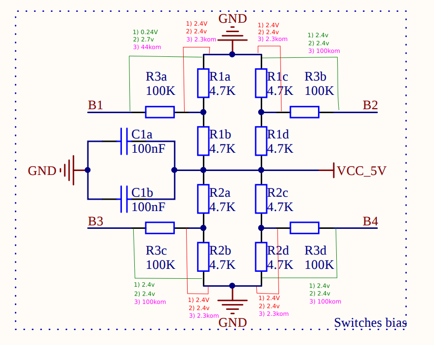

I got strange nummbers in Bias switch B1
1) Turned on RX, volts on all bands exept 20/30m
2) Turned on RX volts on 20/30m
3) Oms when switched off
If i understand correctly B1 need be same as B2,B3, B4
Ilvars

How i understund Bias circut, on all B1 B2 B3 B4, need be same parametrs, I do not understud why resistance and volts change in B1, all reistors  ( R3a R3b R3c R3d )is same size 100k on all circuts
I ask this becouse i got problem with D3 diode in Antena switch, i change it to new but mybe i got some more broken parts what need change.
« Last Edit: 21. May 2018, 08:46:05 by YL3CAAE » Logged

Its a standard voltage divider circuit in the bias network. B1 should not differ from B2 to B4 of course. Its all the same.
If you have such a strange difference here you might have a problem at U1 or probably R1 or C1 and a possible solder bridge or wrong component (U1) ?!
D3 is a whole different story. Here you need to pay attention on RFC2 !
In case you put HF on it and have a bad SWR this coil can burn in seldom circumstances. So make sure you use the correct TDK coils here !
