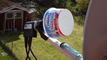

...das ist mein Wetterschutz für die Antenne ....

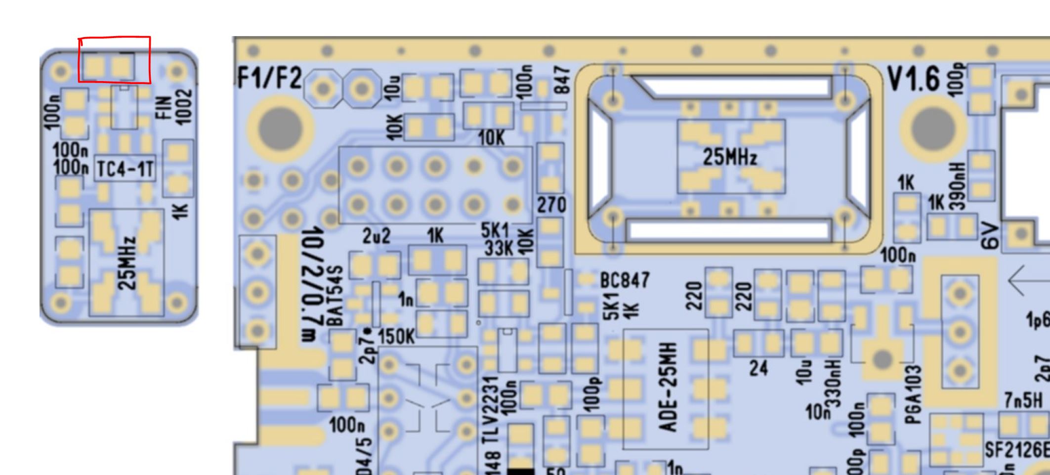

Artur,
this week i have received the Parts/PCB/case and today the LNB with Poty - many thanks for the quick transfer! I´ve already started to solder the parts.
Addititional to my questions in the thread before i have one missing value on the additional PCB for VCTCXO.
See the picture for detail.

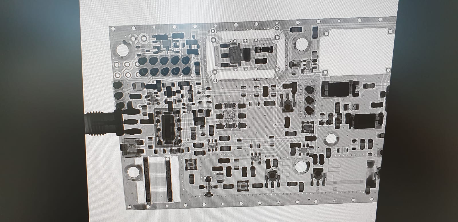

« Reply #57 on: 07. November 2020, 14:06:28 »
My PCB´s, checked by Xray...
DL2GMI - Michael (H44MI)
Posts: 377
Re:New TRV using ready module
« Reply #58 on: 07. November 2020, 14:06:43 »
And the second one...
