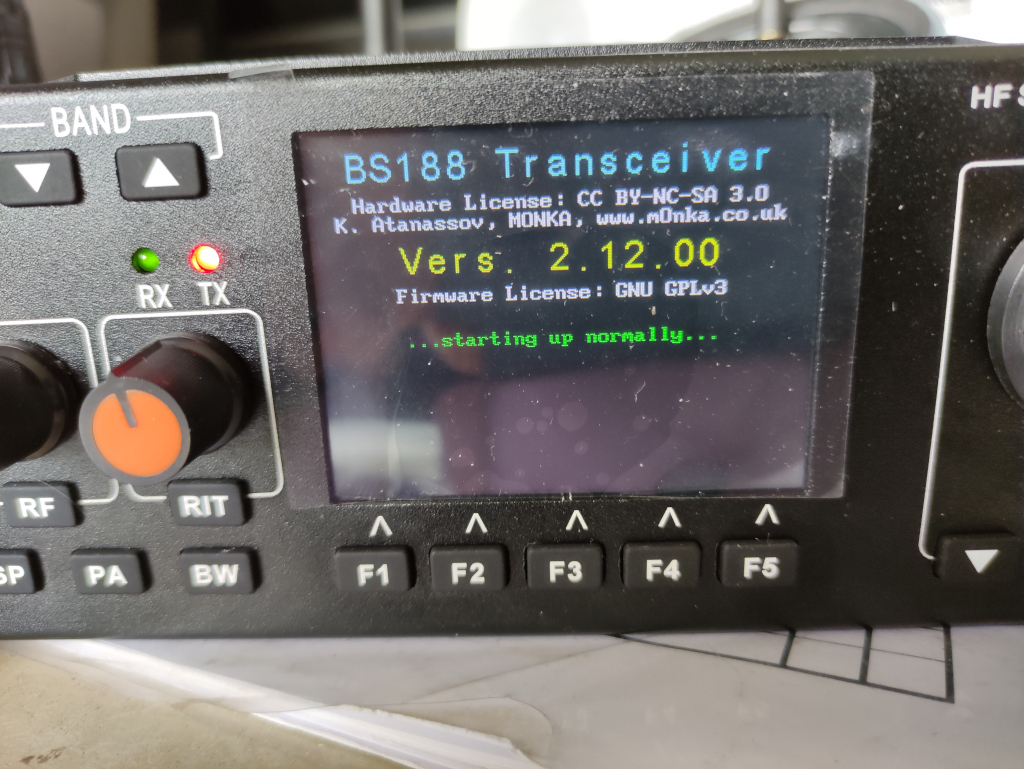

Hi all,
i buy a SDR transeiver
RS918
I have 1 ask
For flash possible with this SDR transeiver?
it's OVI40 board
« Last Edit: 03. June 2021, 14:10:15 by FRS2013 »

I think it is mcHF board because of the buttons under the LCD and the 2.8" LCD itself.
Very easy: ask the seller.

I think is OVI40
but F or H
beacause it's on my picture information board
So i think OVI40
but no good when i flash

The chinese cloners have been faster as the OVI40 developer (thats me). The message you see is meaning that your rf board is using an oscillator chip I firstly want to use for OVI40 rf board. But during development I saw so tremendous problems in mixing concept that I buried it and started DUC/DDC development.
So what you see never was developed ready - but the chinese cloners picked it up because it is cheaper in production
Welcome to reality!
BTW:
The message above shows that they have modified firmware. "BS188" never was and is a text message of original firmware. So they have to publish the source code - otherwise they are breaking the licence of the firmware...
Look at the schematics and you see what hardware is present.

I i try flash DFU on linux command
fw-mchf.dfu
Start Hardware
but my display ILI 9341 is not blank but not init correctly
i think on this firmware is ILI 9325
Display i have, but working Rx TX
mine is ILI9341
i try again
my command
dfu-util -d -R -a 0 0483:df11 -D fw-mchf.dfu
« Last Edit: 03. June 2021, 20:11:52 by FRS2013 » Logged

So the problem is init display
i read code ui_lcd_hy28.c
for know why my display ILI9341 not working good
it's display HY28B SPI for ILI9341
ask:
if i change my display hardware ILI9341 for 9325 it's work after?
or change code for ILI9341?
thank's for your reply
Xavier
Re:BS118 / RS918 You Know?
« Reply #8 on: 04. June 2021, 06:32:26 »
I do not know HY28B with ILI9341 controller. But it is interesting! Please ask seller for the link to the source code. They have to publish it otherwise they do a license breach. I think it is not as complicated to apply init code (included decision which one to use).
I do not see HY28B using ILI9341. All 2.8" LCDs which have this controller are using total different pinouts. Never used on mcHF. UHSDR does not support cloned devices which left mcHF compatibility...
« Last Edit: 04. June 2021, 06:36:32 by DF8OE » Logged

« Reply #11 on: 05. June 2021, 06:51:13 »
Bad news for now
Bonjour,
Lu
je recherche pour ce poste les codes source GNU GPL merci
Lu
Hier 04:29
What's GNU GPL ?
Qu'est-ce que GNU GPL?
Alibaba Translation
Hier 14:34
copy left linux open source
Lu
i seek the code open source RS918
Lu
01:56
no open source code
Pas de code open source
Alibaba Translation
08:48
Non lu
no it's open source it's write on diplay when switch on: "Firmware License: GNU GPLv3!!!!!!!!!!!!!!!!!!!!!!!!!
