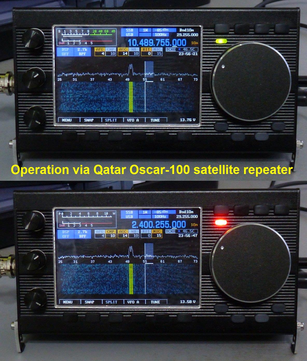

Danke Thomas,
kommt mir sehr zu passe. Für die Nutzung des TRV von Artur
gesunde vy 73 aus Erfurt
SP3OSJ
Re:display frequencies up to 99 GHz
« Reply #2 on: 15. April 2020, 09:56:19 »
Hi
It is now fully integrated with TRV on QO 100.
All day, Danilo
Artur
« Last Edit: 15. April 2020, 10:30:51 by SP3OSJ »
SP3OSJ
« Reply #3 on: 16. April 2020, 11:49:02 »
Hi Thomas
This can be set from the keyboard.
Press LCD wherever there is frequency
Then "Frequerncy Set"
Artur
« Reply #4 on: 16. April 2020, 12:01:39 »
Quote from: SP3OSJ on 16. April 2020, 11:49:02
Not sure about this, the virtual keyboard frequency variable is only 32bit (the value must be <2^32, so below the ~4GHz) :https://github.com/df8oe/UHSDR/blob/4ecbff8b626662af6c7300e92830199ee001ab5b/mchf-eclipse/drivers/ui/ui_vkeybrd.c#L545
although may be wrong, not have here the rig to check this.
« Reply #5 on: 16. April 2020, 20:26:14 »
I did not check yet in the code, but the frequency entered using the touch screen is almost 100% sure the "real" TRX frequency, i.e. the frequency without the offset. So there is no immediate need to fix this as long as we keep it this way.
Otherwise we would have to teach the touchscreen input the difference between transverter and non-transverter operation.
« Reply #8 on: 17. April 2020, 06:35:11 »
Einfach auf die Frequenzanzeige tippen und dann "Frequency Set" wählen... War intuitiv. Gleich der erste Versuch führte zum Erfolg
« Last Edit: 17. April 2020, 06:35:27 by DF8OE » Logged
OE1FHB
Posts: 224
« Reply #9 on: 17. April 2020, 06:40:54 »
Danke für die promte Antwort , aber bei mir öffnet das nur
ein Touchfeld zur Band Auswahl .
FW.:2.11.81
BL.:5.0.3
#Vy73 OE1FHB
Friedrich
« Reply #10 on: 17. April 2020, 06:45:06 »
Friedrich,
this is only for 3.5" or more display (480x320), there is no possibility to show the keypad on usual mcHF display - not enough space for graphics.
My fault- not proper info for 480x320 display in wiki. I must add the screenshoot feature first to make easier the wiki expanding.
OE1FHB
Posts: 224
« Reply #11 on: 17. April 2020, 06:49:15 »
Danke Slawek , das ist das Problem !
Vy73 OE1FHB
Friedrich
« Reply #12 on: 17. April 2020, 06:56:31 »
Thomas, in fact I have the 3.5" display in both mcHF and OV I40 UI too, almost forgot abut the initial mcHF display
Anyway, the short info is in this thread (7th answer):
https://www.amateurfunk-sulingen.de/forum/index.php?board=19;action=display;threadid=1072
« Reply #13 on: 17. April 2020, 07:07:51 »
So here. A soon as the 3.5" appears I have modified all my mcHF and OVI40 for usage of the higher resolution LCDs. If I get a device for repair which has the 320x240 I feel like beaming in the stone age  ... But for all the owners of a clone which has poor housing so that you cannot add bigger LCD we should publish a comparison of "what does not work with small LCD". E.g. "full size WF / scope" for example. And I think no developer is working on new features for the small LCD - everything that will be added is for higher resolutions...
« Last Edit: 17. April 2020, 07:08:25 by DF8OE » Logged
« Reply #14 on: 17. April 2020, 08:29:13 »
yes, for the current point of view on level of development stage the 320x240 display looks like a little "oldschool" type, but when I recall the first look at the project Chris shown us, I was very enthusiastic and thought this will be enough, this was a good job by Chris&co over 7 years ago, plenty clones still selling today. But... if someone stays at certain stage he really steps back. We are moving forward with development of UHSDR sometimes faster, sometimes slower but still having a lot of ideas. I hope the old display will not make the life harder too much for developers like the 8086 was a kind of obstruction for later chips from Intel... So, if one may move to the bigger screen in mcHF, well... it is highly recommended!
