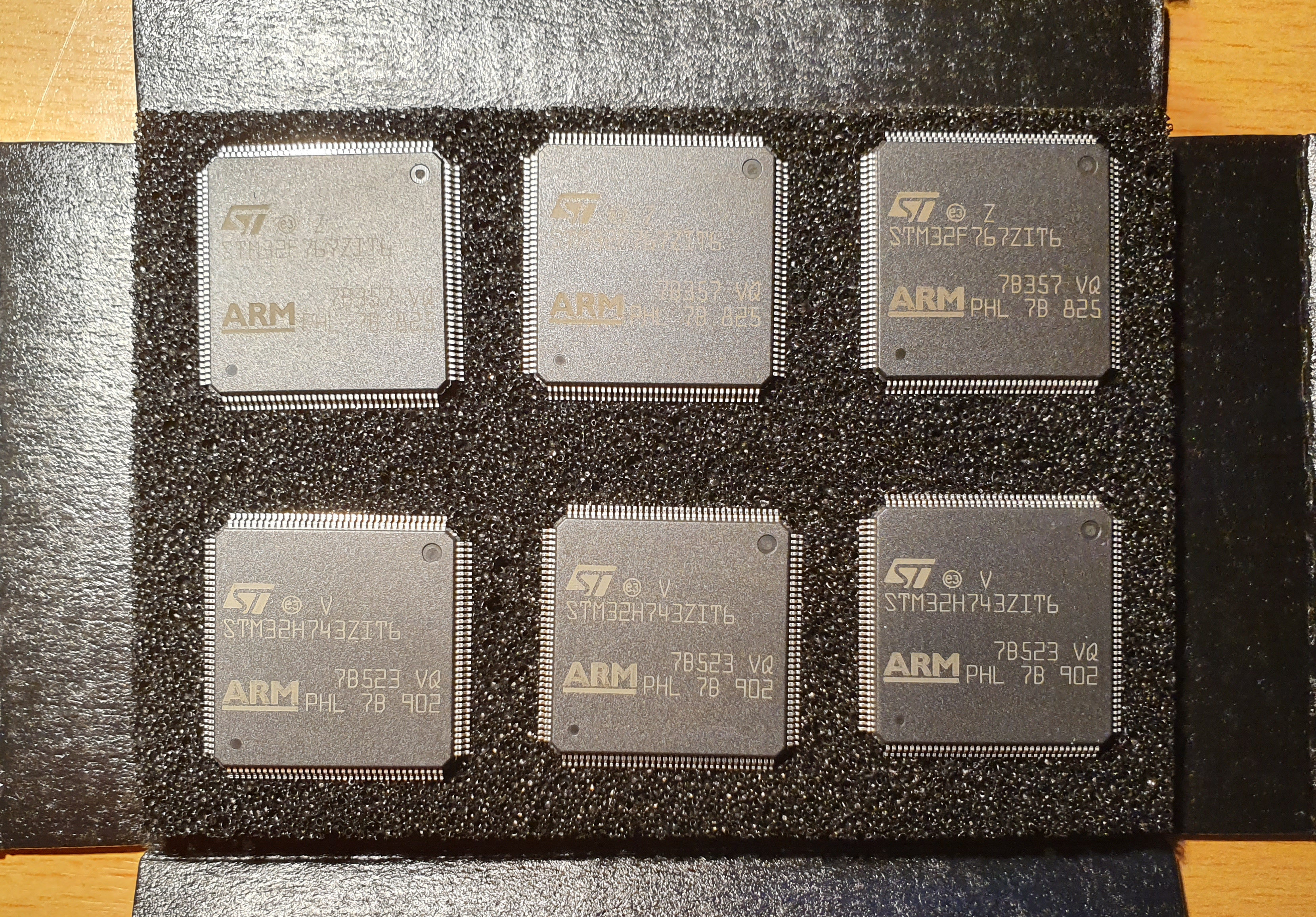

Co
Posts: 79
Re:STM32H7 series revision: Beware of the changes!
« Reply #12 on: 18. July 2019, 13:04:05 »
Hello Thomas,
will be a long wait. This version not available before end of the year.
regards
Co
DG8YGW
Posts: 93
« Reply #13 on: 19. July 2019, 19:51:11 »
Hi Co and Thomas,
73 Ralf
Ralf, DG8YGW
JO31LM  DOK L03
« Reply #14 on: 19. July 2019, 20:06:30 »
using a slight modification to Dave's motto from the EEV blog: "There is only one way to find out, take it apart solder it in its place".
I looked through the difference between the revisions, and the only ones relevant for us are
- the divider of the ADC provides now half the clock to the ADC but we are not nearly close to the max frequency when sampling, so I guess, not a problem.
- Flash write sequence changed: This could apply to us, but that would only affect the bootloaders ability to flash firmware and the flash config storage. If this is the case, we can easily fix that in software, but you would in any case have a working board with only minor fixable problems.
