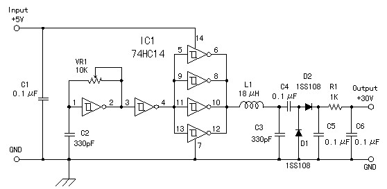

So, for those of you who would want to have a full-break-in functionality or a zero time delay from receive to transmit, there is a challenge to try to add a DC/DC up-converter (well shielded, of course) and then measure the eventual TX signal degradation.
I have not tested that but is should work to improve the T/R switch behavior at TX. DC/DC in attachment is only as an example from the web.

you have 100% and well understandable described the problematic which causes signal distortions if you use PIN diodes and do apply only 4V (the 5V are not reached under working conditions). Because of an external voltage multiplier again produces RF and is much more difficult to implement as a simple relay I have proposed the "relay solution".
