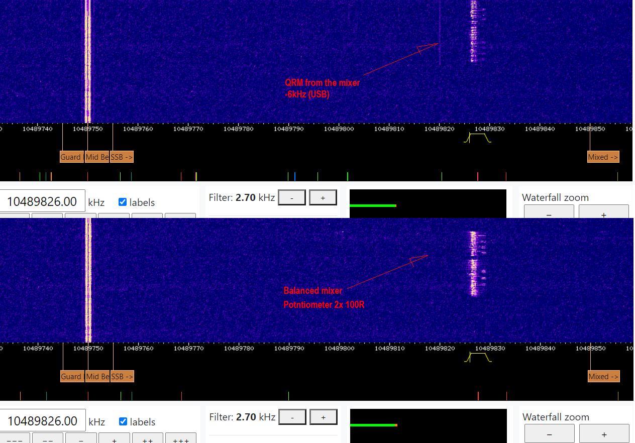

It is important to have a good balance of the TX mixer.
Artur
Re:Frage zum kalibrieren
« Reply #12 on: 19. July 2020, 13:28:51 »
Hi Artur,
yes, it is. But the balance is frequency dependent. So a potentiometer only will give best results on one (hopefully small) band. I have investigated this long time ago and wanted to implement it in OVI40 mixing concept. But that would have been one additional configuration parameter which is (non-linear) frequency dependent. After lookin at that I noticed you need TWO potentiometers: one for 0° and one for 180° input. You have to set the voltage difference AND the absolute voltage for all frequencies, of course everything non-linear frequency dependent.
That was the point I stuck up with optimizing mixer concept. If you want to use it as a single band solution you can take potentiometers. For wide range you need D/A and possibility to store sets for multiple frequencies. This has satoryboy implemented ~ 1 year ago. Ic have struggled much with myself but I decided not to merge it into main branch. There are more than one reason, but one of them was:
- I get many mcHFs for repair. Only 5% have adjusted I/Q settings - most are unconfigured. So why implement something that is not used in most cases?
Radio operators are lazy like all other people. It must be self-adjusting or (better) does not need such complicated manual configurion.
SP3OSJ
« Reply #13 on: 19. July 2020, 15:09:11 »
Hi Andreas:
Du musst es so machen:
Artur
« Reply #14 on: 19. July 2020, 15:19:10 »
That is what I alreday wrote: you need configuration for each band... Doing it with potentiometers splits up configuration to two important places: firmware AND hardware. Of course possible  Signal purity gets much better. But what about leakage of LO? I have investigated that you can minimize this using DC offset at the mixers, too. But unfortunately the settings differ from the ones which gets best signal purity...
