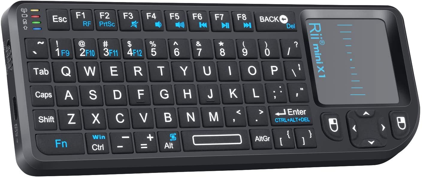

Here is a picture of it maybe it will be recognized.
Chuck

Re:USB Keyboard
« Reply #3 on: 28. April 2020, 13:12:45 »
Yes, this one works out-of-the-box and perfectly.
