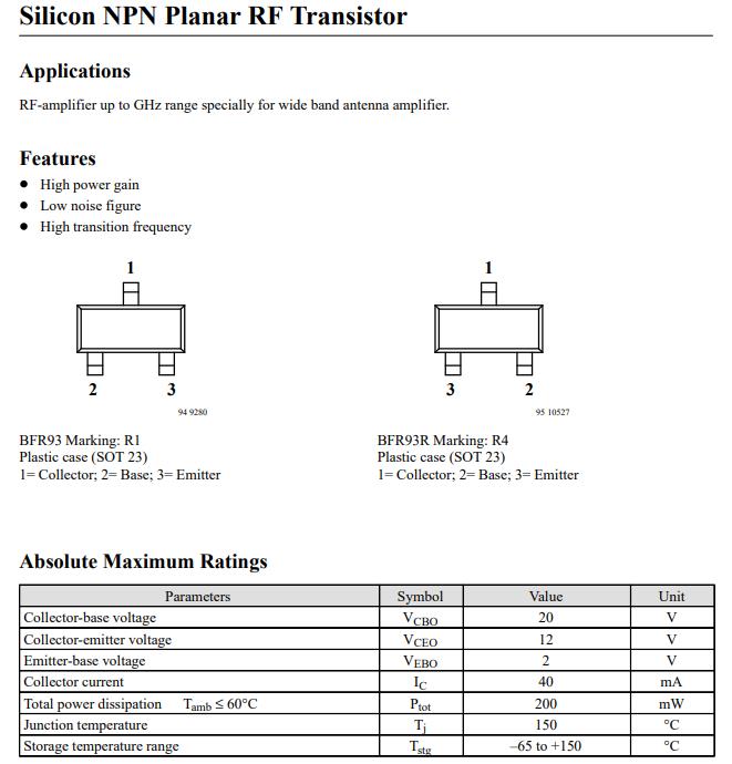

No defekter BFR93!
You need to know:
The "BFR93" transistor is made in two variants:
BFR93 and BFR93R.
Re:Empfindlichkeit des mcHF 0.4 versus FT-817
« Reply #3 on: 07. August 2019, 12:26:38 »
Hi Artur,
you are right - but: Chris told "it was working before"...
SP3OSJ
« Reply #4 on: 07. August 2019, 13:39:18 »
Hi Andreas
OK, maybe others don't know it, so it's important information.
Artur
« Reply #5 on: 07. August 2019, 14:31:04 »
Of course - can confuse much if you do not know this...
