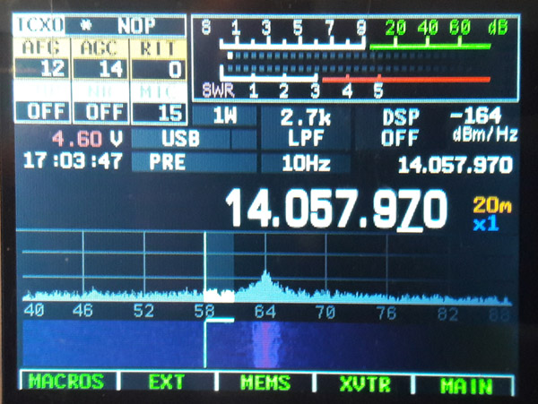

How can I enable time on the display ( like your in the picture) on my original 2021 mchf 0.6.3. Trancsiever?
Do I need to add some modules?
I add the temp. Sensor and this work ok.
What is the "pre" icon on your display?
Thx for reply

Please look "UI-04/05-N-031 Enable STM32 Real Time Clock" here:
https://github.com/df8oe/UHSDR/wiki/Recommended-Modifications
"PRE" - Preamp, on the pfoto is relise for TRX Amber, my own project. Amber have preamp and attenuators in RX input module.

Otherwise, these days I'm bothered by the temperature sensor and I don't know if it's broken or if it's something related to the new firmware. The MCHF after some thime just stops working and the frequency indicator turns red and the station starts behaving very strangely. It only helps to turn off the MCHF. When switched on again, it reports an error that it does not detect the temperature sensor. Is it due to the firmware update to 2.12.m1 (so far I haven't had these problems) or is there something wrong with the sensor. Otherwise when I ordered I ordered 5 pieces but in my opinion there is little chance that there is a problem with the sensor itself. Then over time it reports “NOP” at the temperature point and then over time I can put the TCXO to OFF and back on ON. What do you think? Have you ever had similar problems? Thanks in advance for the reply.
