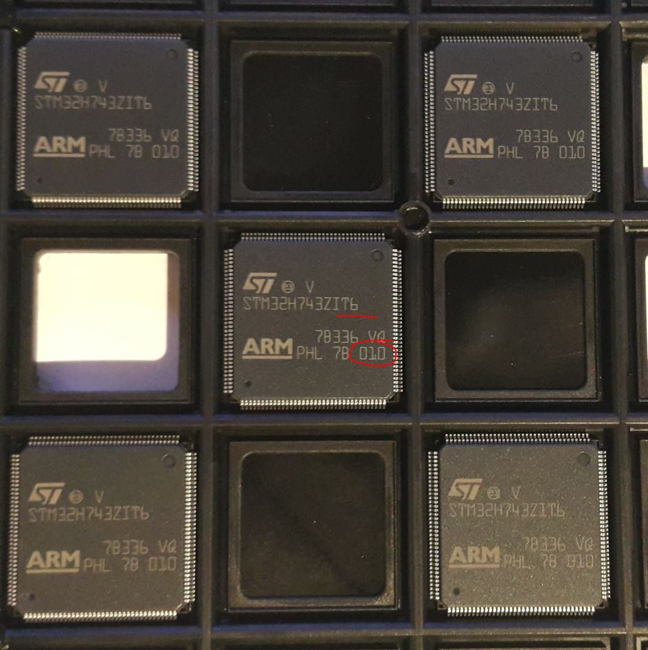

Farnell has old revision and wants to sell them. Both are marked as 400MHz. Starting from the revision 6 these cores have 480MHz, if the core has "V" marking on the case, then it is capable of run at 480MHz. Please read the manual about the changes they made. Also, there is no such marking as "U" in ordering info looking to description in datasheet.
Re:Mod-fw of UHSDR 2.11.91m1
« Reply #8 on: 28. October 2020, 22:28:09 »
As previously said: obsolete. Your chip is almost two years old...  Must be an intermediate version or "something". As said, look to the current pdf from ST: https://www.st.com/resource/en/datasheet/stm32h743zi.pdf, page 352.
Directly from ST factory:

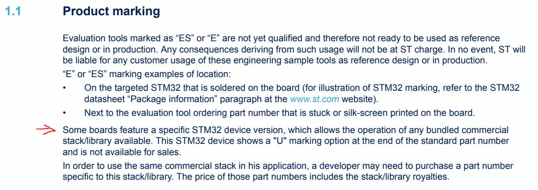

I called the ST and have the answer for "U" marking - there is no silicon change, the "U" marking means that the chip price contains fee for licensing some linked libraries for example MicroEJ (Java). So why it doesn't work is a question to author.
Also found some explanation in nucleo boards:
