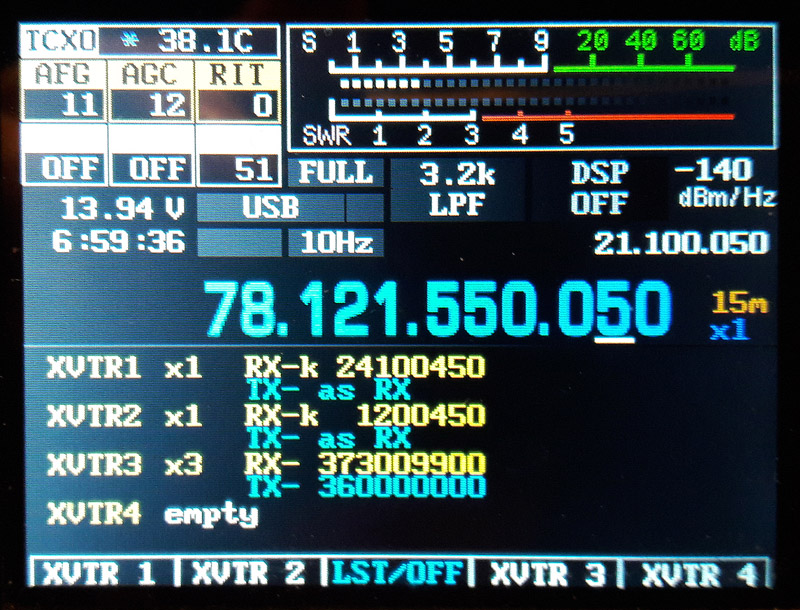

I'm posting a new version of my mod firmware of UHSDR, 2.11.89m1. Almost all improvements were made at the request and suggestions of colleagues:
- Added on-the-fly "AF GAIN" power control for Gen band. Useful when working in the civilian CB band. Since in Gen the power factor is calculated as an approximation between adjustments of 80 and 10 m, the scaling of the calculated value is adjusted, 100 - 100%.
- Added the ability to select the creeping line colour - Display Menu -> Ticker Colour.
- Added the ability to select the duration of the edges of the generated CW signal (3, 5, 8, 10 ms) - CW Mode Settings -> CW Sign.Eg.Smooth, ms.
- In the mode of operation with an external transverter, a full-fledged indication of the tuning frequency up to the 76 GHz range has been made (at an offset from 500 MHz, its step is coarse to 1 kHz and the adjustment step increases by 3 orders of magnitude). Also added F-menu of transverter presets for 4 cells. The menu is selected in the F-menu "carousel" by long presses of the M1 button, see the screenshot below. F1, F2, F4, F5 buttons are responsible for memory cells. Long press - save transverter mode settings, short press - call. Short press of the F3 button - enable / disable the display of the cell list, long - disable the transverter mode and return to the main F-menu. Long press M1 you can call any F-menu, keeping the transverter mode.
