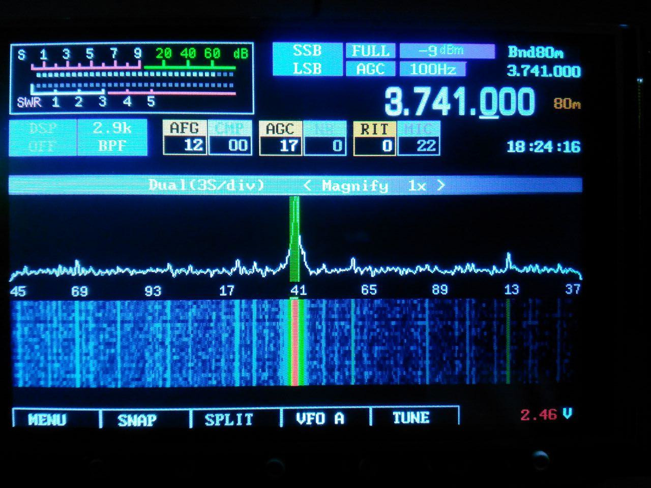

RX and TX work from 10KHz up to 75MHz (153.6MHz sample rate) using 14 bits in RX and TX (shortwave block of PCB). And the decision to use 14 bit and not 16 bit was ok - look at the following screenshots. 16 bit ADC are much more expensive as 14 bit. I think for 99.99% of all user profiles 14 bit is enough.
I attach a screenshot from RX with a signal generator attached at an input level of -9dBm (!!). Receiver is not overdriven.

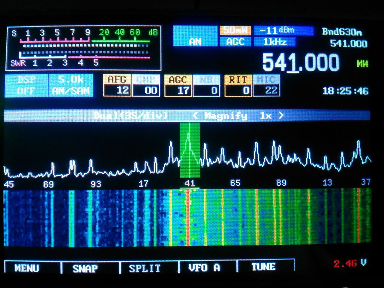

Following a screenshot of RX performance in the evening hours on 540KHz. Bombastic signals - but no intermodulation or overdriving to hear. Antenna is a double zepp with 2 x 27m legs in 16m height over wet ground.
There is no input filtering used - complete signal from 10KHz up to 75MHz is linear digitized. You do not have any gaps or parts with lower performance. Due to the nature of DDC there is no translation - you do have the receive signal in the center of the screen. We actually can show a spectrum / waterfall with 192KHz bandwidth - that will be increased in the future by software improvements.
