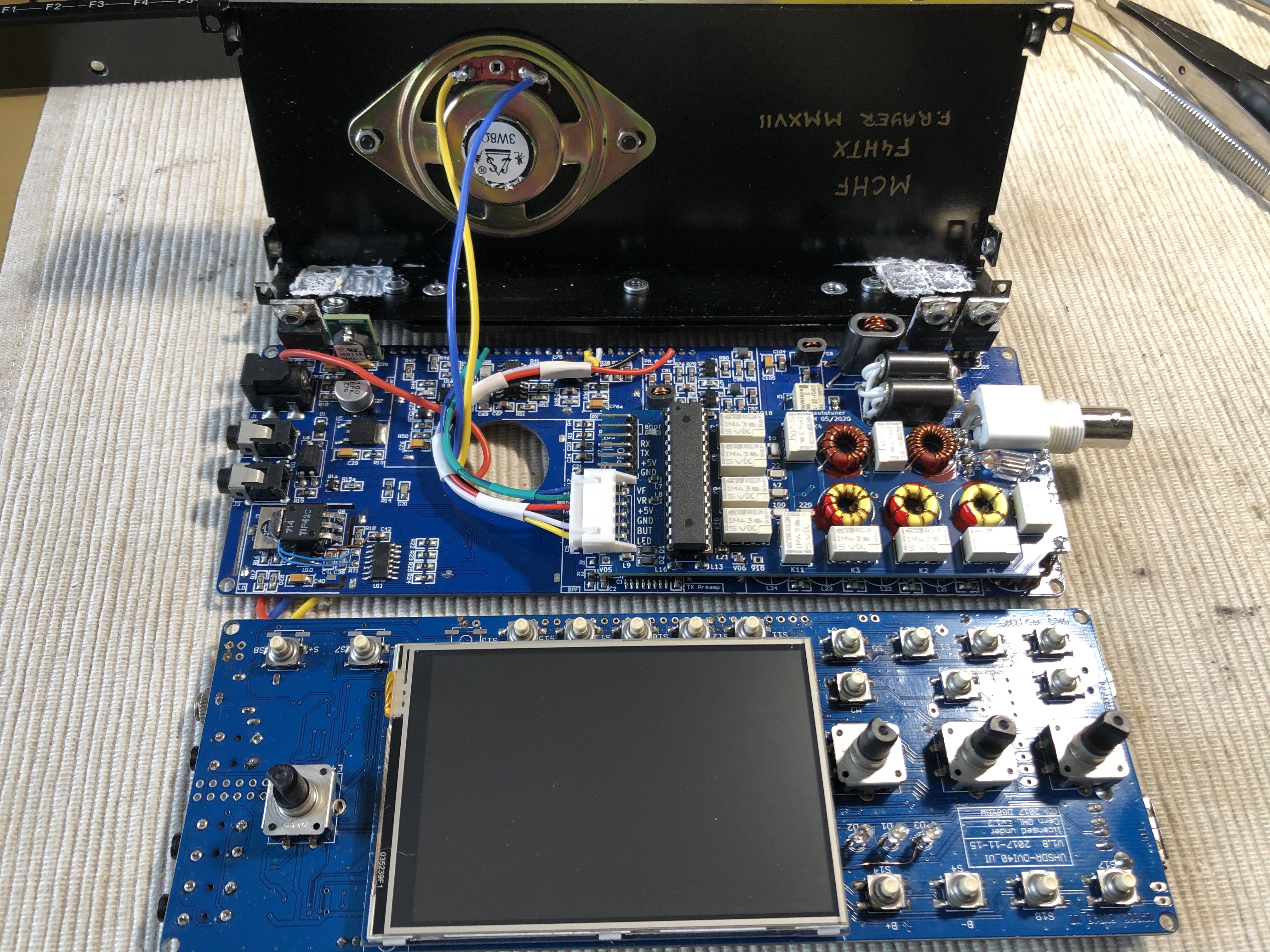

Hello Friends,
This message to share with you the results of this weekend bench work.
On one side I had a classical homemade mcHF from the v0.6 PCB's running UHSDR software, 2.8" screen and slow cpu ; on the other side OVI40 UI plugged in an mcHF RF I never took the time to nicely fit in a box.
So I decided to upgrade the original mcHF :
- swap the mcHF UI for an OVI40 UI
- install the UT0UM AT100 internal ATU
- swap the 7805 for the Murata OKI-78SR
Everything went fine, the ATU from Alexey UT0UM, which wasn’t initially designed to work with the OVI40, fits nicely as far as you do the following :
- move LED yellow wire from pin 22 to pin 20 on the mcHF RF board
- in order to use the blue LED D3 for the ATU, remove R116 resistor
- connect OVI40 UI pin 20 to the anode of the blue LED D3
- cut and lift the (not grounded) pin of the choosen switch encoder in order not to interfere with OVI40 UI
The attached little video demonstrates the tuning of an 21meters long wire (and an adequate earth counterpoise) with the ATU.
There is still some metal work to fit the original top case, open it for the 3.5" screen and reuse the soft buttons...
This is not revolutionary stuff, but this will end with a very convincing little rig, the OVI40-UI is far more usable than the original mcHF and because of the internal ATU, you travel lighter.
73’s
François

The guts inside the beast
