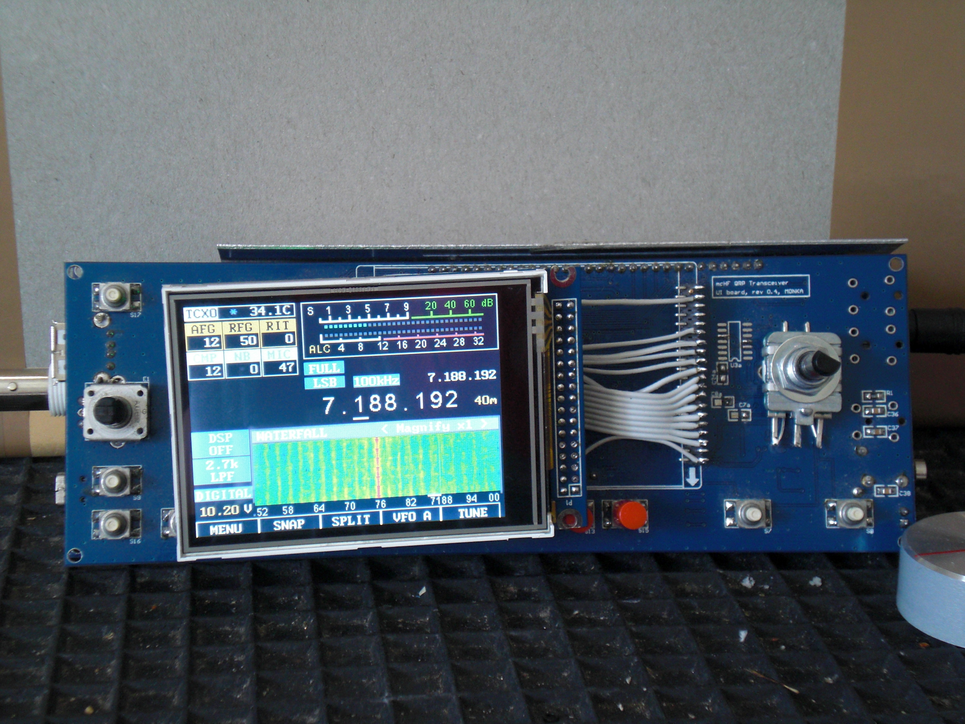

Hi Andreas,
if I get HY32D parallel mode with ILI9325, will it work? I know it would require additional wiring etc,  but at present I dont have much option.
https://www.waveshare.com/product/displays/lcd-oled/lcd-oled-2/3.2inch-320x240-touch-lcd-c.htm
I am ready to something what you had done, along with backlght mod if this HY32-ili9325 works.
https://www.amateurfunk-sulingen.de/data/uploads/lcd32-on.jpg
Thanks in advance.
vu2iia
« Last Edit: 04. May 2021, 11:39:58 by vu2iia » Logged
Re:does FW support waveshare HY32D (SSD1289 & ILI9325) ?
« Reply #3 on: 04. May 2021, 14:15:30 »
I am not sure ILI9325 will work - never tested it. ILI9486 does work (480x320).
