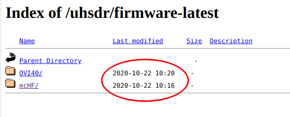

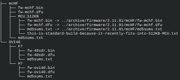

Re:Firmware load fault
« Reply #10 on: 25. October 2020, 11:19:43 »
It is a browser issue!
There is no file inside the small-mchf-folder. It is just a symlink that points to the file that is not working for you
Additionally "firmware-latest" is not a folder at all. It is a symlink that points to archive/firmware/2.11.91/
Your browser does not check if the contents has changed. "For providing the user the fastest access" it simply takes the contents from its cache...
You already have downloaded firmware file for mchf, but never before for mchf-small. So the first one is taken from your cache (and is outdatet) and the second one is downloaded from our server  If you suggest: "but before it has worked" I answer: there was an update for your browser or you are using a different now.
