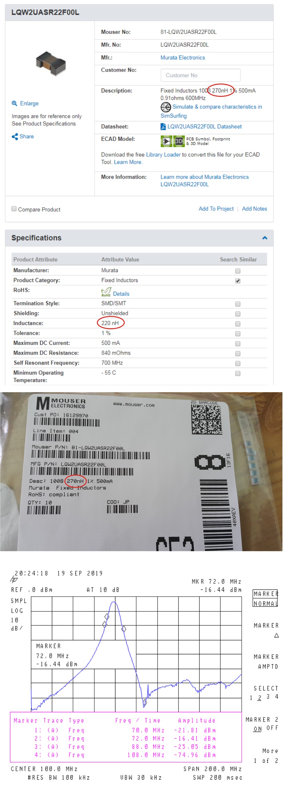

Hello,
probably happened many times to everyone, but please be cautioned using search for components in Mouser (other resellers too). The result: filter freq has been up shifted by 8MHz... My fault - didn't tested before soldering. Measured with VNA: L=219 nH.
Anyway, the warm greetings were sent to Mouser

yes - exactly...  Fortunately samples from Coilcraft are on the way since 2 days, hope in Monday I will continue... So far RFsim simulation works great - I say this because I had some doubts yesterday

Hi Artur,
and same like with my order the Manufacturer Part Number is correct, only the description is wrong but the search engine on mouser.com uses it and finds wrong parts...
