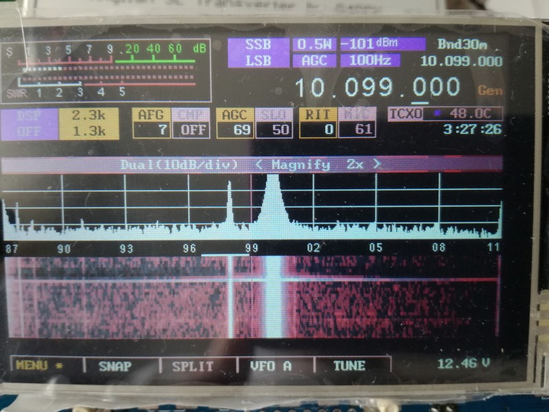

« Reply #19 on: 08. September 2018, 12:46:35 »
Hi both,
no, please check the two pictures of the UI scope display showing the two signals. It is not in the level of the nearby signal. It is the signal displayed inside the RX window. The very same two that exhibit -50 dBc.
The input signal is 10.100 MHz at -53 dBm.
73 Bojan
PS: LCD is still covered with plastic foil so the picture quality is not good.
ok, only one picture at a time!?
EDIT2:
This signal is "you can see, but you can not hear"!

« Reply #20 on: 08. September 2018, 12:54:58 »
What you see is an alias signal which only pops up in magnification. That is due to too low RAM and horsepower on mcHF - we cannot filter data which is needed for display in a better way. It will be gone if you choose magnification = 1.
Yes: only one attachment at a time.
« Last Edit: 08. September 2018, 12:57:18 by DF8OE » Logged

« Reply #21 on: 08. September 2018, 13:35:16 »
Hm, Andreas,
I think it is the same kind of signal (the same level, same bahavior) as you can see in Zoom = 1, but this time 2 x 12 kHz across. Guessing.
73 Bojan

« Reply #22 on: 08. September 2018, 13:53:35 »
The signal you see in magnify = 1 is the mirror which exist because of not 100% eliminated IQ misbalancing (phase and amplitude). It is always present at translated mode and is positioned 2 x Xlate in direction of the LO working frequency.
If you change magnify mode of course Xlate is not changing - so this signal stays "as it is" in magnify = 1.
