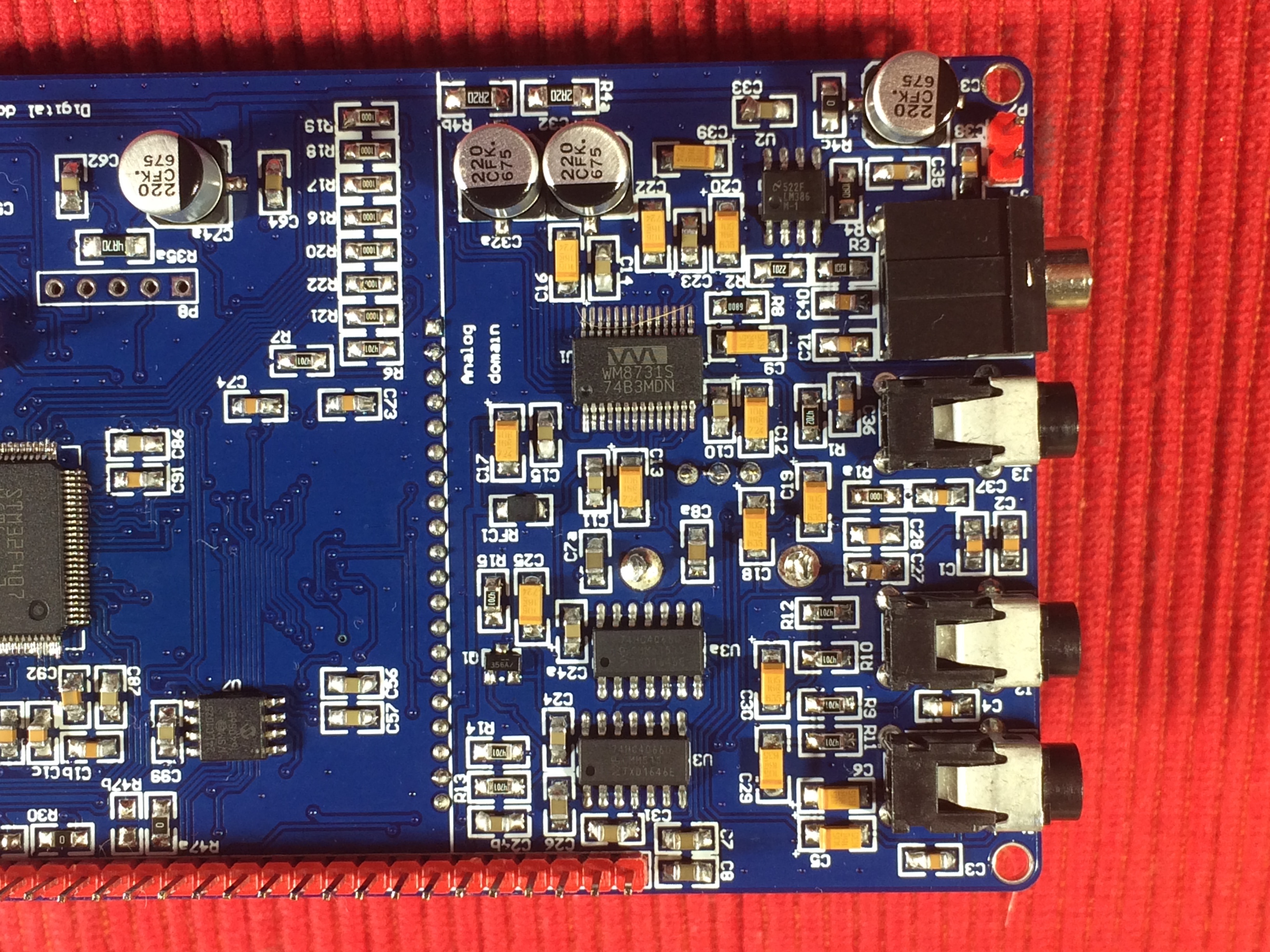

It might be hardware problem of the codec. All my components came from large reseller, in this particular case the codec is from Mouser. I might buy from another source and swap the chip. This seems to be a long shot as two mchf with two UI with the same chip problem...
I attached a pic of this area of the UI board I shot on Nov.2017. I will tear apart the mchf and put the UI board under my binocular. Two codecs wrongly soldered… Why not...

It seems the cause has now been identified as hardware-related. Whether the software can deal with this, is another question. But if the codec is so resistent to reset and the shift seems to be randomly distributed (as can be seen in your two videos having different frequencies with unwanted signals), software correction is not straightforward.
I have seen the same phenomenon with a totally different codec (SGTL5000), so this seems to be common and as Andreas said, would go totally unnoticed in every quality control at the chip factory.
It is really good, Francois, that you built two mcHFs, because that was the final clue that put us on the right track with the codec ;-).
So, yes, hardware check (soldering) or even codec exchange would be the right solution here, I think.

« Reply #119 on: 03. September 2018, 15:08:59 »
Hello Andreas and Frank,
Thanks for the explanations, so, this is what I will do now :
1. Thorough exam of my UI board under the binocular
2. I will swap the codec with one of the ovi-40 kit still not soldered
3. Report to the team…
